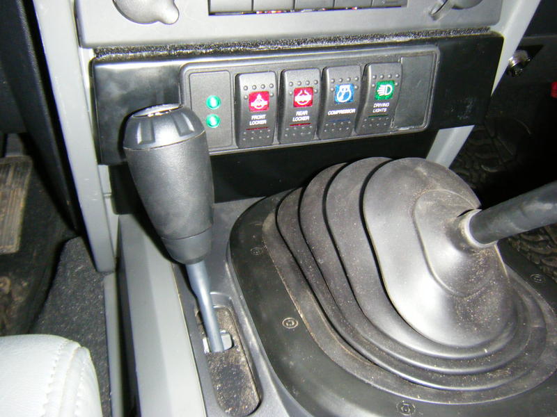

I needed a switch panel, but was not pleased with either the product, or the cost of what was out there. I started by removing the lower dash panel and remaking one using 16 gauge steel. I bend it in a brake and welded up the end cap pieces. There is place for 5 switches. As you can see in the pic I am only using 4. The far left LED's are my locker indicators for the Rubicon axles that I put in. All is wired in with a painless auxiliary fuse block, and relays. All switches also come on with the lights. I used some velcro to hold it in place. It clears the shifter, and looks great in my opinion. Some scrap steel and about $60 in switches.

Some of the switches look crooked.

It does look that way. They are actually straight in a pre-cut plastic panel that holds the 6 switches. I noticed the same thing from the pic though.
