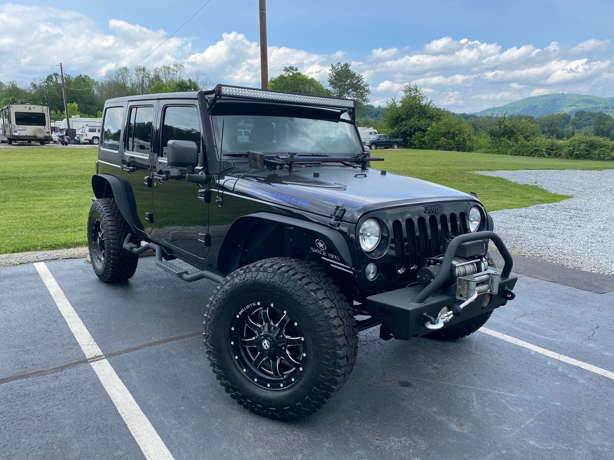

Hey All,
Been a long time since I have been on this forum, wasn't much of a poster on here anyway but I am looking for possible help. Buddy of mine is looking to buy this jeep for his son and had hoped I could be there to look it over for him but plans changed and I am not near there. Jeep is located in Columbia, SC so it could be traded into this dealership by a local or maybe even a military person transferred in or out of the area. Posting a picture, I think, as it has some clearly unique identifying marks that hopefully somebody will recognize. If you do, looking for information on the set-up as far as lift, known issues if any, gear change- things like that.
Thanks in advance

Try fakebook, the forums are just about dead and only a handful of people on them everyday. Clean, built for looks, doubt if it ever went off road on anything but dirt, at least the cheap winch has synthetic line on it. I would give $0 for the mods it has and would actually want a discount from the KBB value.

I agree looks clean but other than the tires (not wheels) most of the stuff I would not put on mine. the side steps look like a disaster waiting to happen first time offroad. the winch is a VR10000S so that is actually a good winch. I have made a lot of hard pulls snow wheeling with that particular winch. Why on earth tho he has a roller fairlead with synthetic is beyond me. Tell your buddy if he gets that rig to put a hawse fairlead on there if he is actually going to use the winch.

It doesn't need to function properly, just look cool.

Yep, the Jeep I am getting my soft top off was one of these. Paid a crap load of money for additions, never used off road.
