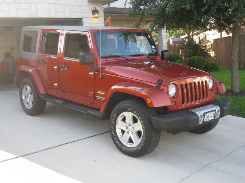

I tried to do this for a while when planning my lift. I actually really liked the look of the factory sahara rims. I was working with Discount Tire and they actually got a set of the terra grapplers into their store and allowed me to do a test fit. My Observations were as follows:
  1. Interference between tire and air dam. Not major but worth mentioning.
  2. Interference between tire and front sway bar. Major problem.
There are basically two solutions to the problem.
  1. Add spacers. At $100/pair (min), if you plan on doing the spare, you'll need 5 but will have to buy 6. That will run you $300 new. They will need to be 1.5" minimum to clear the front sway bar. The problem with this solution is that the spacers are considered a bad solution to many. Supposedly they have to be checked regularly (approx 1k miles) to ensure they have not loosened. Although they are cheaper than an set of 5 rims, the price of the 18" tires will overcome that difference, especially if you are considering having your rig long enough to replace them with another set years down the road.
  2. Change the rims. The new rims will need at least 4.5" backspacing to clear the front sway bar. There are numerous rims out there that meet this criteria and some look really sweet. You can replace your 18" sahara rims with 18" aftermarket, but the rims and the tires will cost you more. I went with 17" myself and paid less for the tires. I bought my wheels and tires at Discount Tire because their quality, service, and warranty are top notch. My only regret was not paying a bit more for the 4.5" back spacing (mine have 4.25" and they still rub slightly at the limits of the turning radius). My rig is also a DD so I changed my choice from Nitto Terra Grapplers to BFG All-Terrain T/A KO's in 315/70R17 (34.4" x 12.4). The wheels are MB Racing Chaos in 17x8.5. i felt This combination would give me the best combination for road/highway/off-road use.
Like I said, I tried and tried to get some 35's on my sahara rims, but I didn't want to mess with the spacers though. So, I coughed up the dough for the rims. It seemed like the best alternative for long-term maintenance and cost. Overall I am very, very happy with my setup. Once I adjust the steering gearbox stops I'll eliminate the mild rubbing of the tire against the front sway bar.
Hope this helps, bro. Here's an image of mine pre-and-post-lift, tires and wheels. Good luck in your choice. Feel free to PM me if you have any more questions.
Attachment 98319Attachment 98318
I think i am going with the spacers for now because i really like the look of the stock wheels. Is that with the 4" lift or the 2.5"? But that's the exact stance I'm looking for. Nice looking rig.
Thanks for the props. Mine has a Rancho 4" Sport Lift. I haven't wheeled it yet but it is absolutely phenomenal on the road. I was worried it would be too much, but it is perfect!
Just keep an eye on those spacers and post up some pics when your done. Those terra grapplers are gonna look sweet on your rig. If I didn't have to drive so far everyday, those would be on my rig too.
