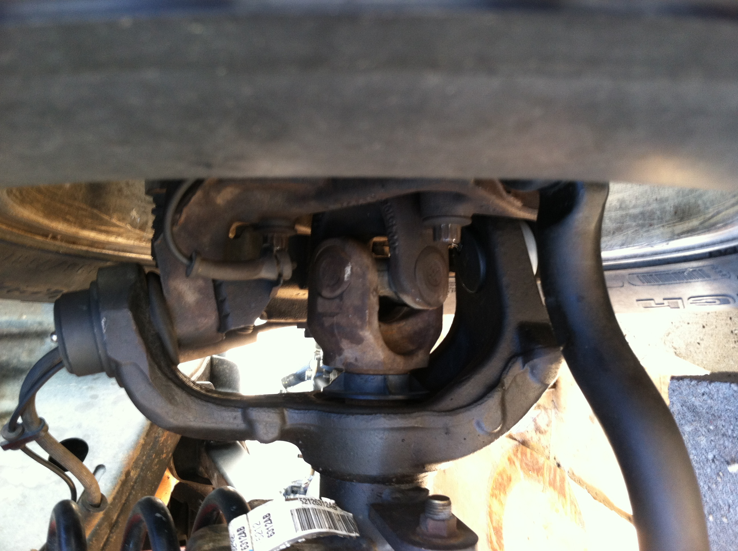

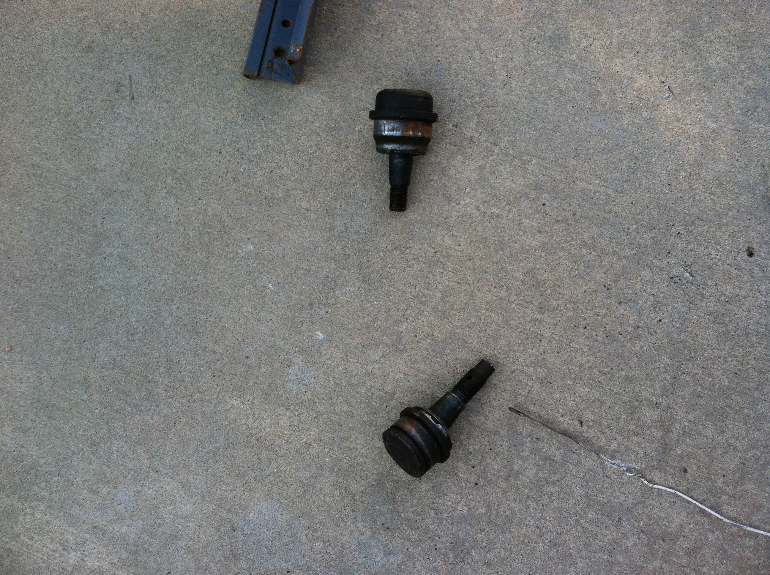

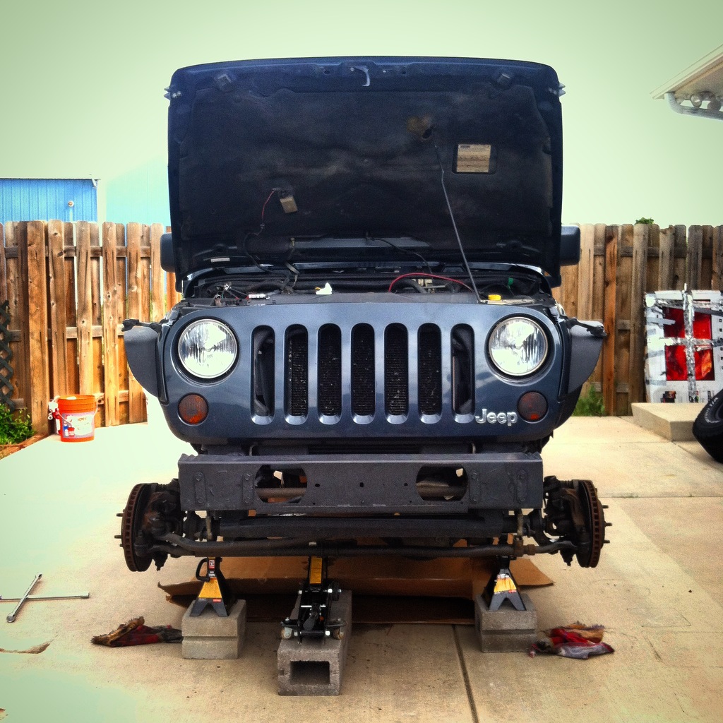

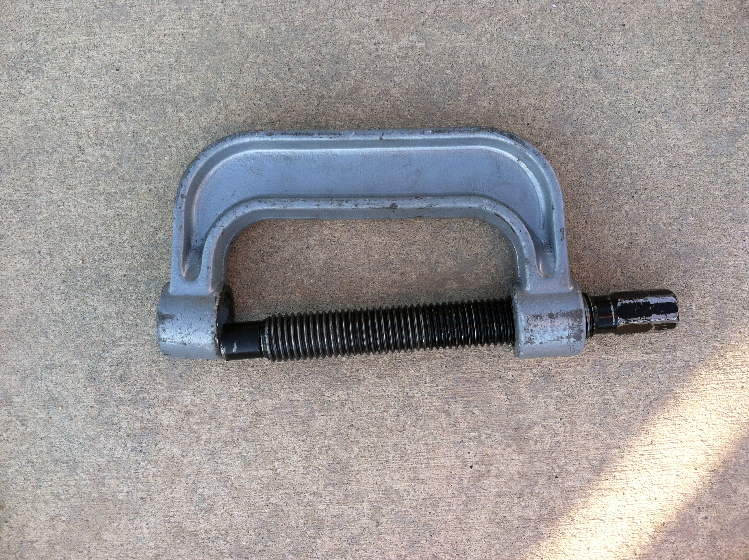

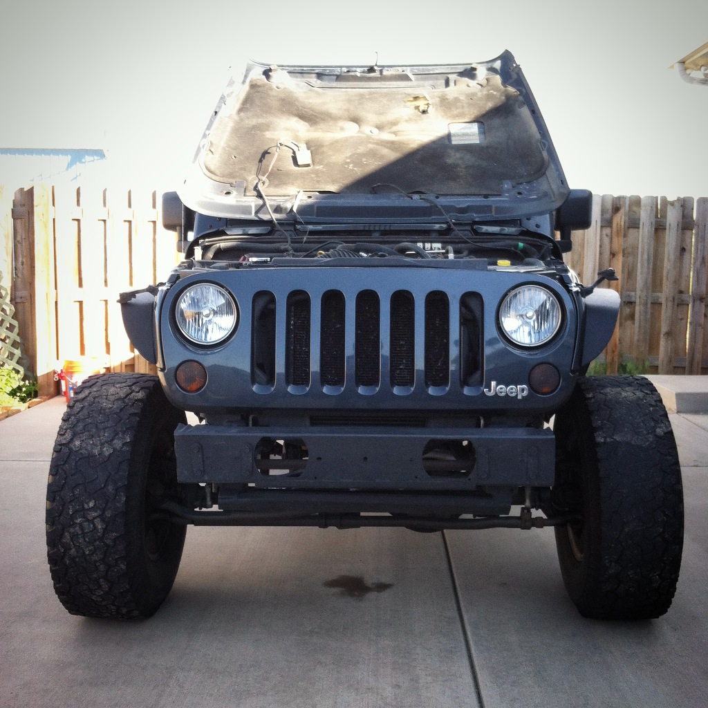

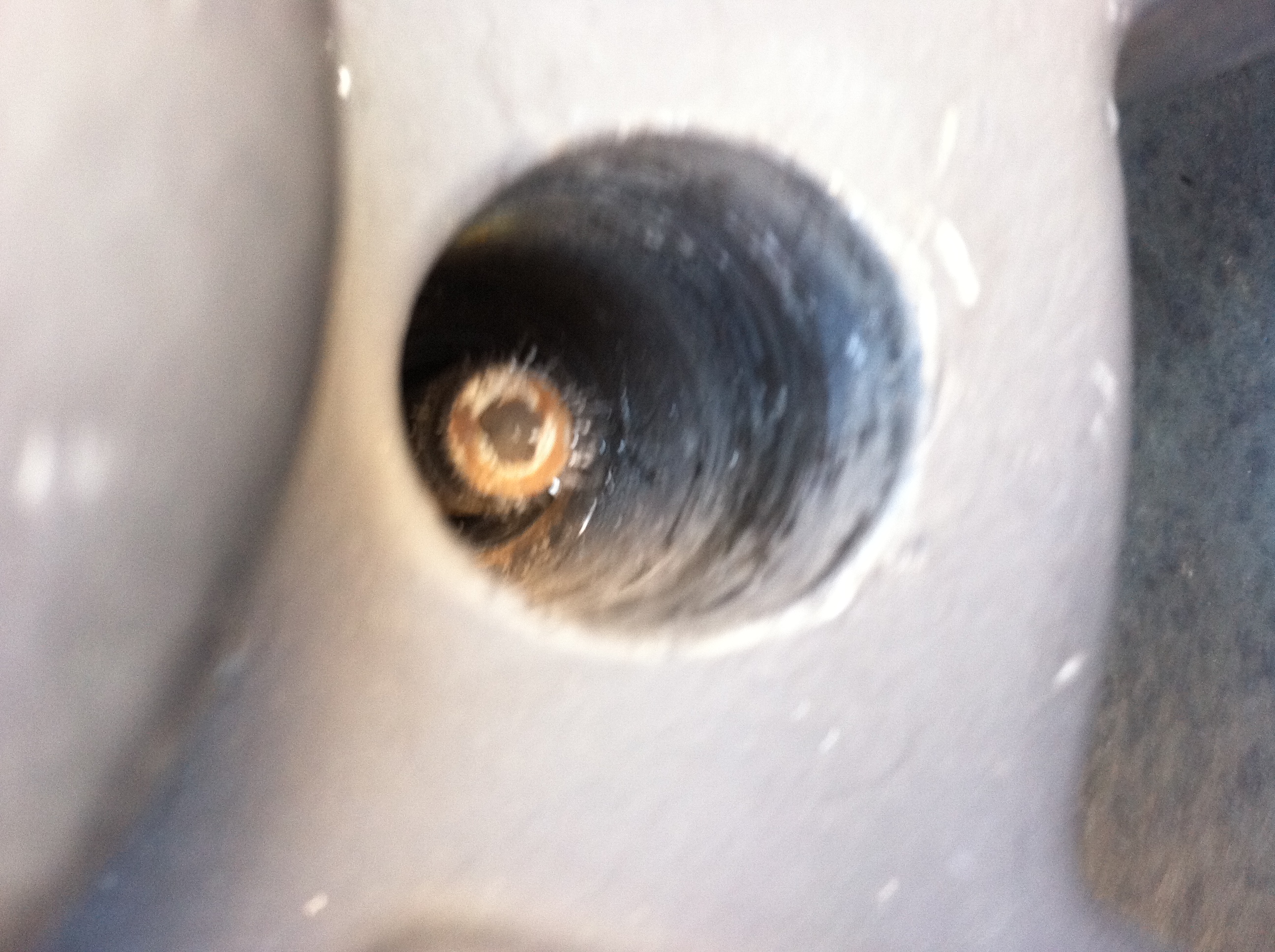

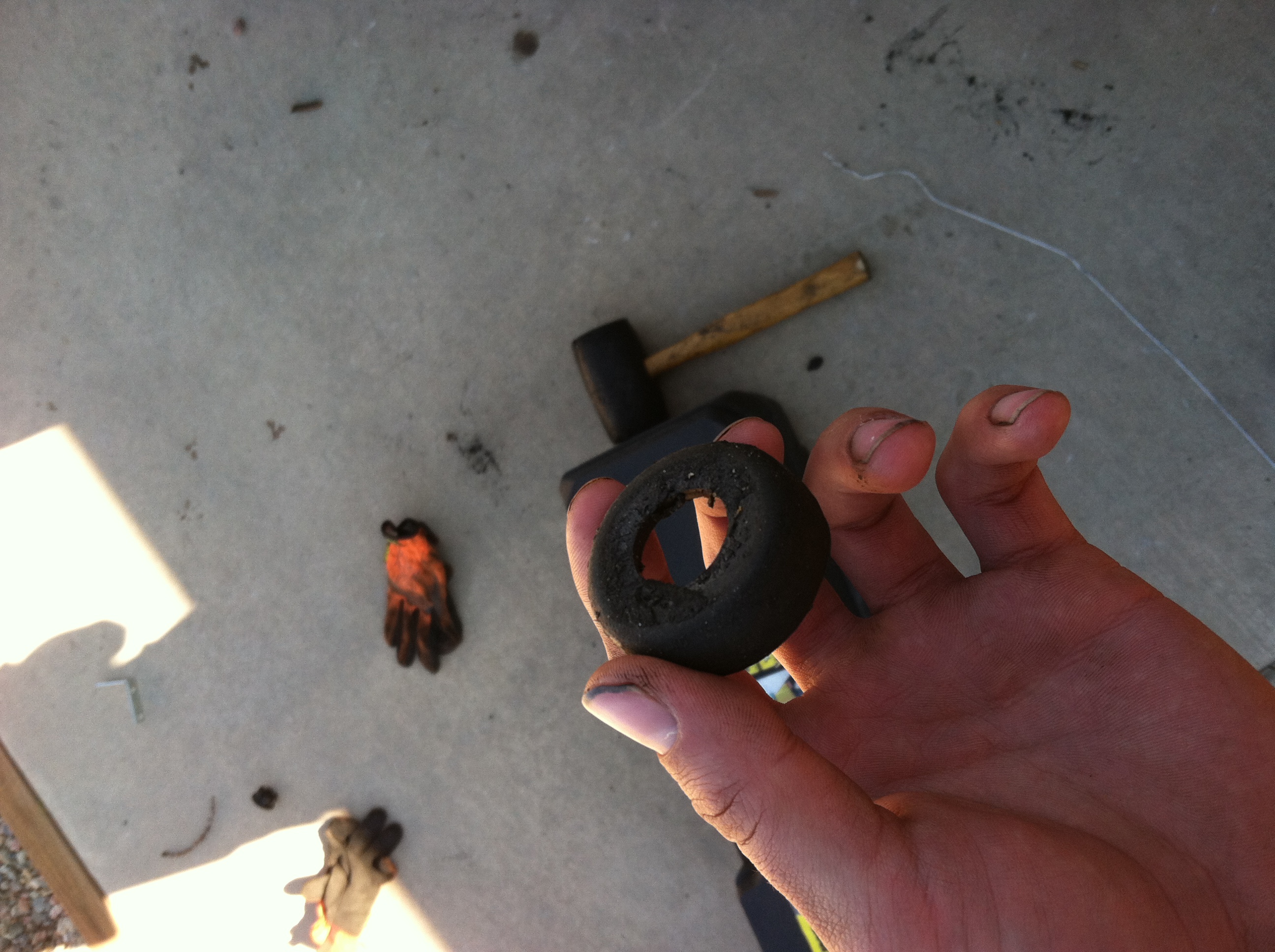

After 4 day, 2 ball joint presses, 1 popped blood vessel, and 100s of negative thoughts about my Jeep and it's creators.....I have finally finished installing Synergy ball joints! Now I wait for my valve covers and she'll be running once again!

Blaming Jeep, not Dana/Spicer? Also, they make a beveled cup just for Dana 30/44 front axle Cs to prevent what you did to that press.

I had trouble with mine a few weeks ago myself. I used pb blaster, a small sledge, a 3' cheater bar and borrowed a mopar suv press kit. Finally got em all out and in. Pita! Lol glad I did them though.

Thinking this is just my mentally handicapped tendencies, but I refuse to bust my ass I'll use an impact. Good 3/4 gun and give it hell.
My experience, little heat and they're off in minutes. Grease up the threads on the press, never had an issue.

Proper balljoint press with the bevel cup and an impact makes short work of balljoints.
