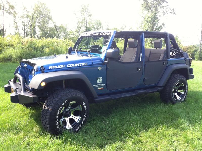

Bestop soft half doors pic request
I bought these for my two door. Now that I have a four door I am short two.
https://picasaweb.google.com/1062488...97096728082530
https://picasaweb.google.com/1062488...97142147824914
With the top down I feel they do not contribute significantly to noise. No different than having the windows down on a solid door or no door. If you have the the Jeep closed up then there is more wind noise. I would not consider the vehicle "closed". You get a breeze when large vehicles go by on the highway through the closed door.
They need some adjustment when new. The top part has three rods that insert into tubes on the bottom part. It is a tight fit for mine and I have adjusted it some but not totally. A loose fit might be bad. Also, the force holding the top of the door against the Jeep (if you have the two piece) is not strong enough to keep the wind from sucking the door out away from the body at highway speeds. To adjust this I opened the door and while standing on the inside side of the door pulled down hard on the top of the door (above the window). This put some curve in the door. Now to close the door I have to pull the top corner out as I close it but it now has enough spring force to combat the wind forces.
If you want to see more detailed pictures I added them to the item on Amazon:

I see. I just youtubed a couple videos and I see what your talking about... I think I'll just stick to factory doors and doorless in the summer. The cost of element doors seems like too much for me, with not much added benefit.
