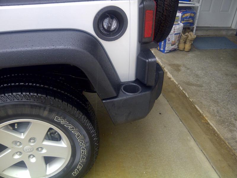

Well I have had my first Jeep a JKU for about a month and a half now and I knew the mod bug was going to bite, but just sure when. Well it bit and over the past week I have done some small cheap Mods while I figure out which route I want to go for the bigger ones like lift, tires, ect... Even though they are not as extreme as most I have seen on here, here they are.....
Cup holders

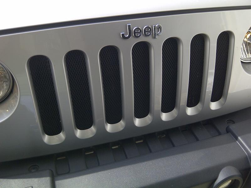

DIY mesh grille inserts

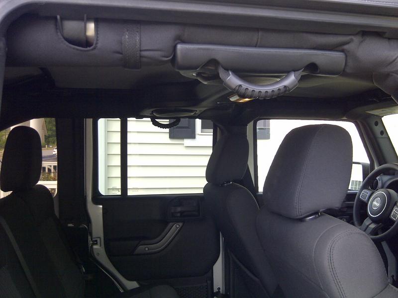

Grab handles

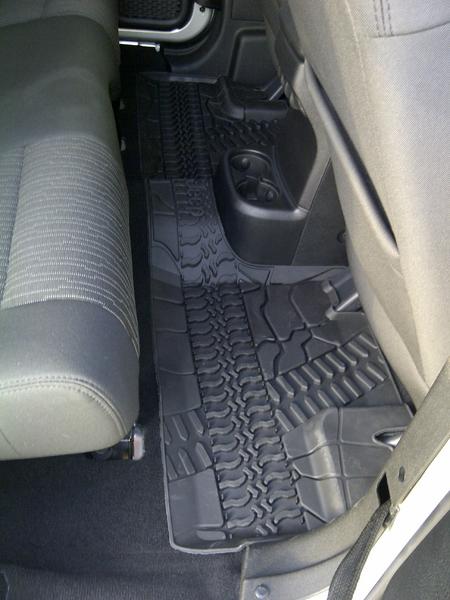

Rear Jeep floor mat

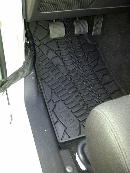

Front Jeep floor mat

How'd u do the cup holders?

Sorry I don’t have pics of the install, but this is how I did it…..
I got two 3 3/4 inch cup holders for a boat, took off the rear bumper, masked off where I wanted them, used a 4 inch hose clamp tightened up to the diameter of the cup holders, traced out the cut line on the tape, used a Dremel with a cross cut tip, cut out the holes, put a little black silicone around the hole to seal and hold them in, reinstalled the bumper. Took less than an hour, and cost less than $13.
