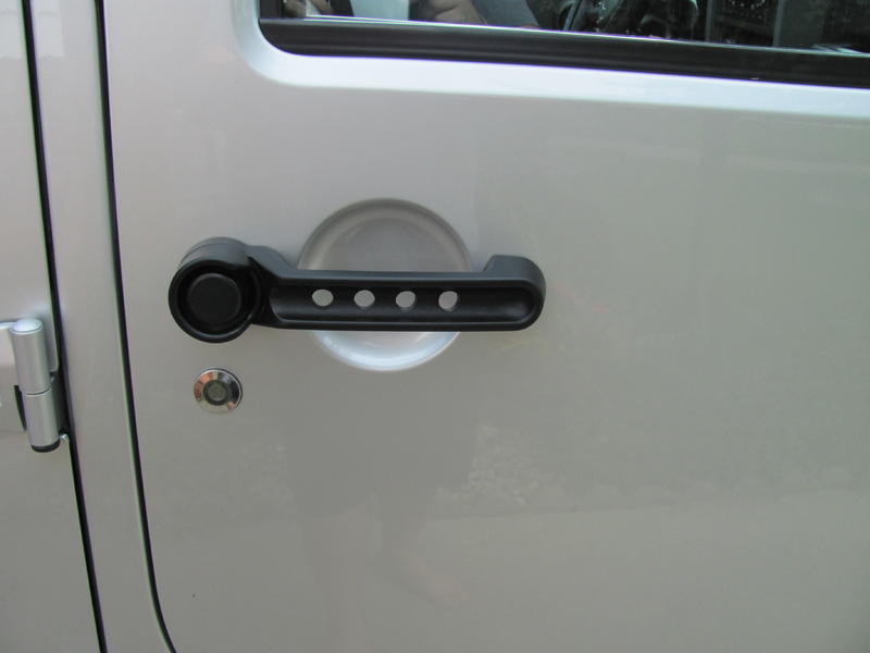

Did this today! Love it! Just take a pencil, mark center on each end, draw a line with a straight edge, measure every inch and mark and drill. Looks Awesome!

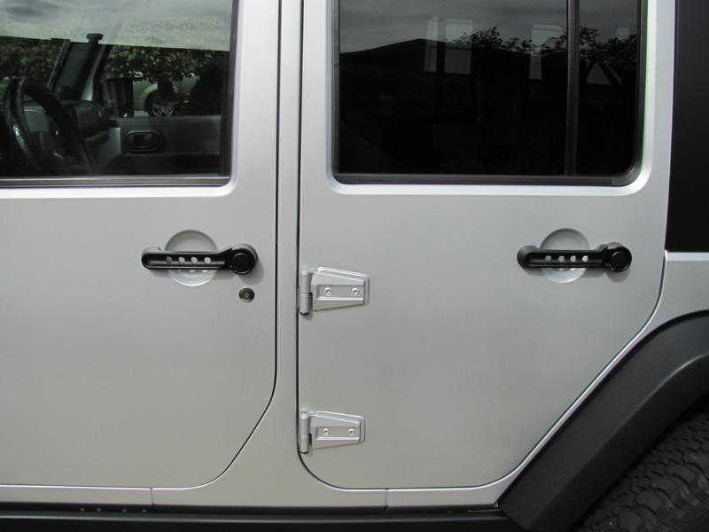

after trying my eye on the rear tailgate handle it was not to my perfection ( middle pic ). I then laid out a piece of masking tape and drew a line down the center and marked the center line at every inch. This was my template and i centered my strip between the round indentation in the door behind the handle. I then took my smallest drill bit and drilled through the center of each pencil mark. Peeled the tape off and moved it to the next handle and repeated the process. Then go back and use a 1/2" drill bit and go through each hole again......WARNING!!!! Make sure you use something behind the handle as when the drill bit reaches the end it pushes through with a good amount of force. I used a flattened pop can wrapped in cardboard and that did the trick. Free and easy mod and a great visual impact on my silver Rubi!
