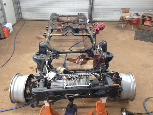

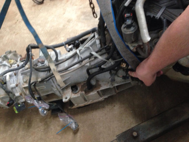

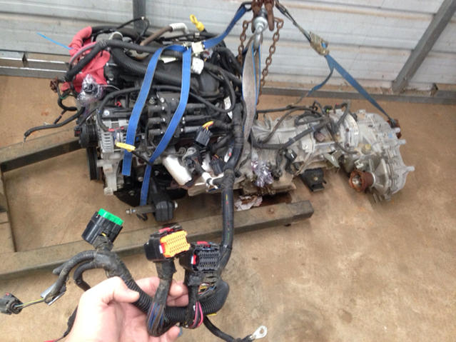

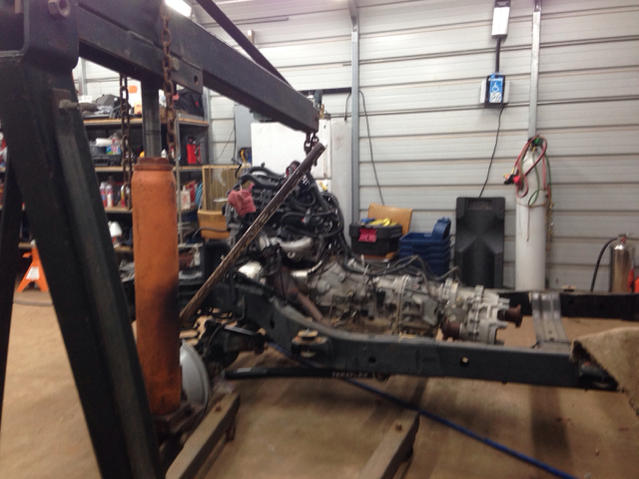

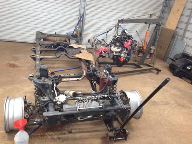

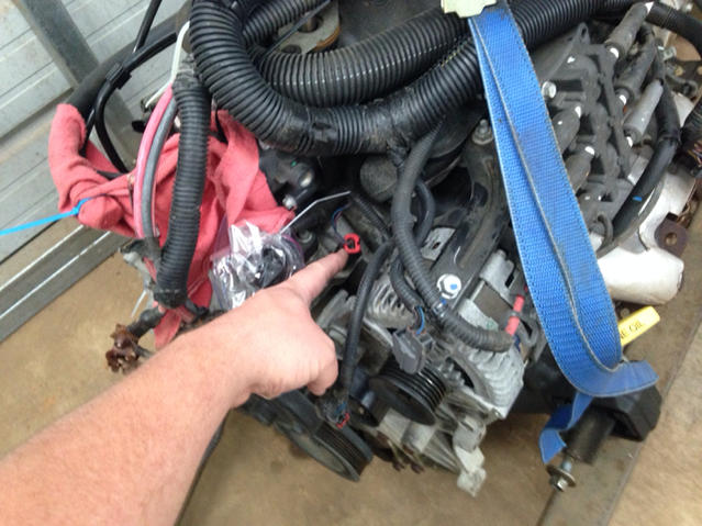

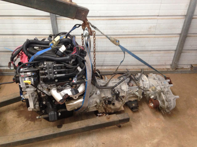

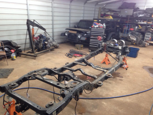

Running outta steam for today. Got motor out, axle disconnected and ready to roll out. Lots of misc parts removed and tagged. Fun times!

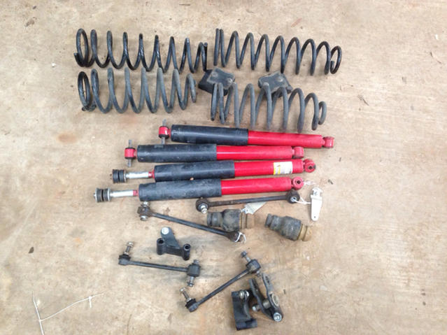

The parts coming off including the 2.5 coil lift with shock extenders(and the factory rubi shocks) are for sale. Just gotta gather it all up and print a check list to be sure its all here. I still have the original shipping box. The kit was only on the ride for about 15k miles. The jeep only had 43000 when i took it apart.
I will be posting the removed parts later this week.

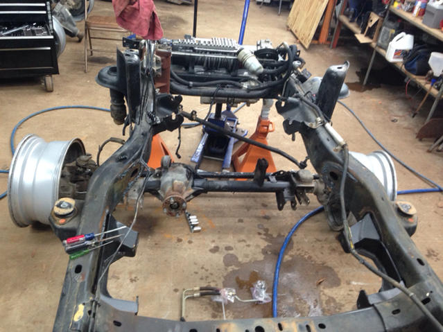

Well i have the teraflex brackets at powdercoat shop getting the powdercoating removed from all the brackets, they are gonna bake the coating lose and then sand blast the dust off. I will have noce shiney steel to weld with. While they do that i will be grinding slag from framerails and prepping it for those parts to be welded on! Yay. More grinding.....

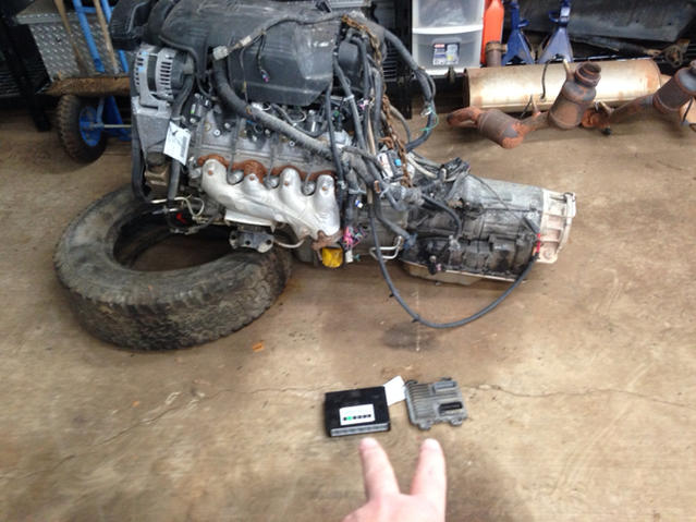

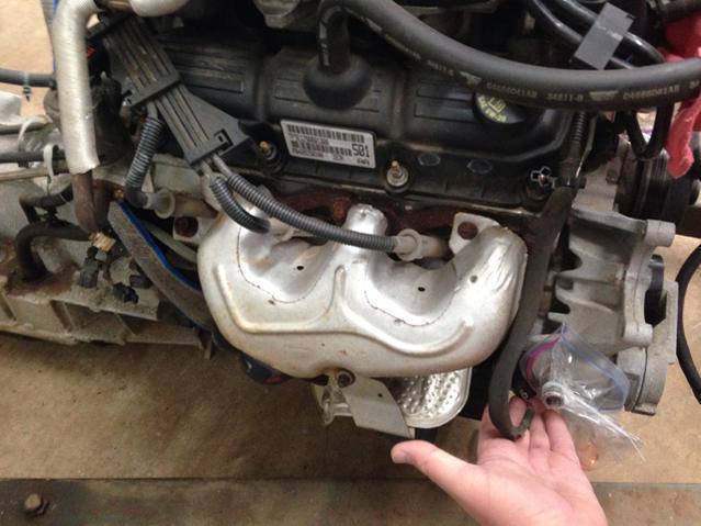

Well im back at it again today, just removed exhaust completely ( and gratefully undamaged-i was getting fustrated with those stupid rubber isolators).
Called MoTech and was told what all i need to salavage and what i need to send to him for conversion.
He needs from the donor truck the-
5.3 silverado 2010 engine control module,
5.3 matching silverado 2010 body control module.
And from the 2009 Jeep JKUR automatic trans-
The dash cluster,
All AC lines that connect to compressor,
The shifter assembly complete,
The computer from driver side fender,
The c100 harness from computer to all things 3.8 engine/trans/transfercase,
The pigtail from the oil pressure sensor,
The pigtail from the coolant temp sensor,
The pigtail from the crank position sensor.
So as i dabble with stripping my frame im also pulling these parts as well. They are a snap to get to when the engine assembly is sitting on center of floor! Lol
