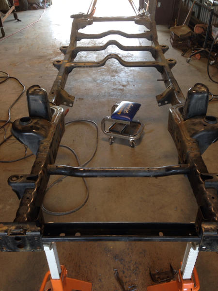

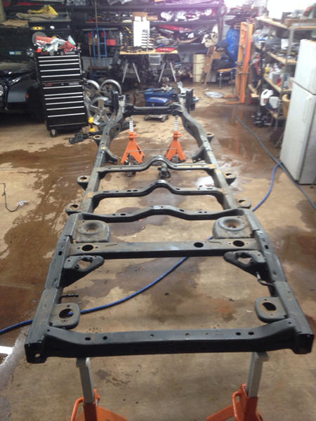

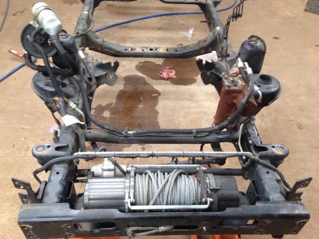

Here is my saturday update. I have finished stripping the frame. All removable stuff has been unbolted/unclipped from frame and all clips removed.
Steering came off all as a unit,
The front swaybar stayed together-yay
The evap and skid came off-skid plate for sale soon, im relocating it higher.
Now to just remove the motor mounts and all the slag remnants of the factory control arm mounts from the torch procedure and buff all that up to weld on the new TeraFlex long arm mounts. Exciting indeed!

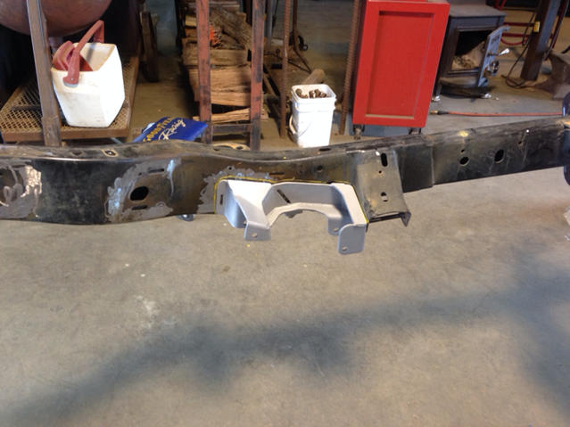

Ok! Progress has resumed. I got my teraflex brackets back from sand blaster today and the bare frame is accross street at my friends house who has welding skills i dont possess.
All of the old brackets have been removed(including the engine mount brackets) and i cleaned up the front long arm mounts and he is welding them on now, when he is done i will go back over and prep the rears and let him weld then gonna drag the LS motor and trans over and mock them up to ensure the mounts are located correctly then weld them on as well. Very exciting. Things are moving along slowly but steadily!
The pics are not in order. Some of the rear brackets we put in place to have an idea where to remove paint from frame rails.
Ill post more pics later of welded parts! Yay!

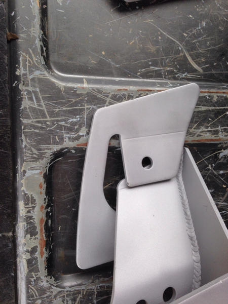

Here are some pics from front welds
