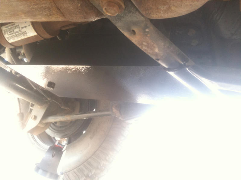

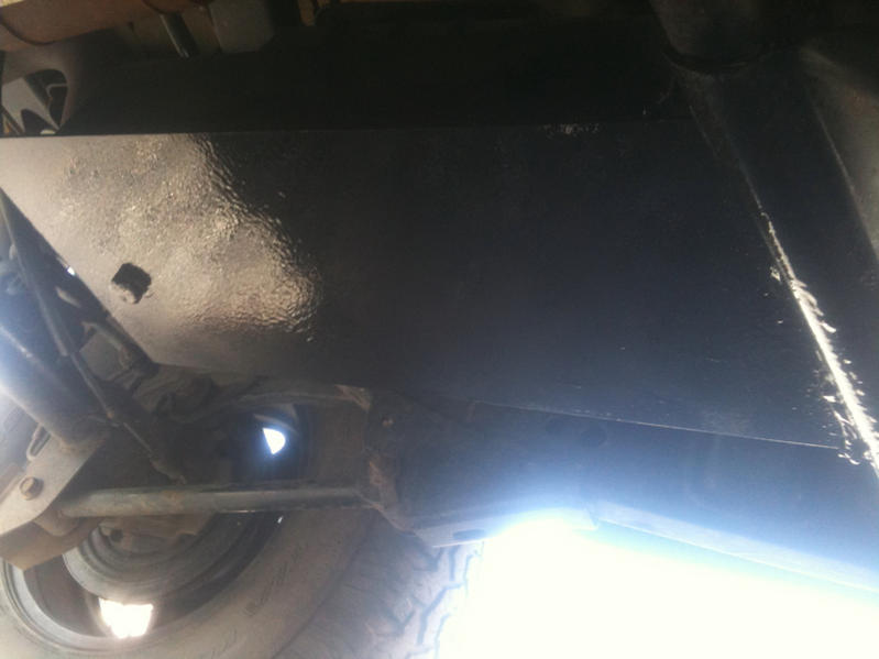

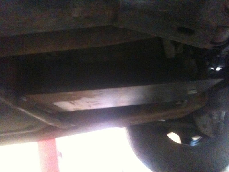

Yep pretty basic. If you need I can take some better pics. All I did was make and L bracket, weld it to the jeep, and build a 3 sided plate and curl the back so nothing stays in there. The bolt goes in the L bracket and the front is welded to the stock skid. Basically I took 1/4 steel and continued the factory skid.
