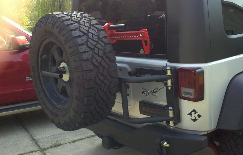

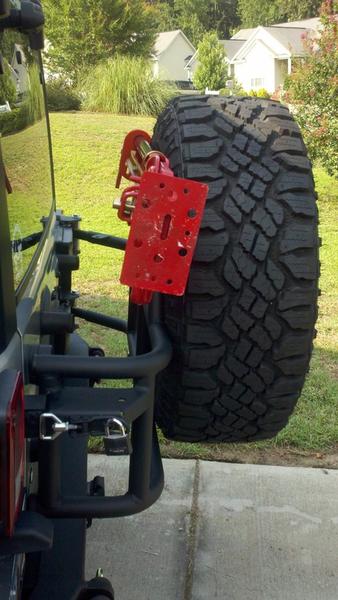

ID:	229021Click image for larger version
The Hi-Lift bolts up to the carrier. The carrier will accept Blitz style cans (has lip on bottom of can). If you want to mount Rotopax or NATO cans you have to purchase additional adapters.
This is a fantastic product but just be prepared to spend several hours to install it. You also have to drill through the body in a couple places. Make sure you download the instructions from OR-FAB's website first, they are most current and also will give you a list of required tools. The other thing to prepare yourself for is relocating the 3rd brake light. OR-FAB makes a kit or there are several others to choose from.
I am truly impressed with the quality and most importantly there are NO RATTLES!!
