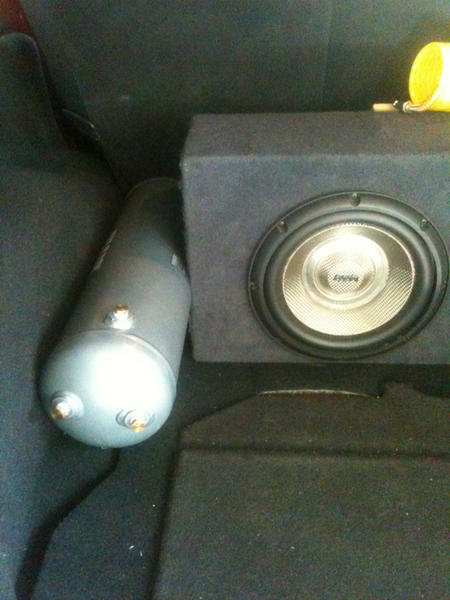

Temporary resting place for my tank because a 2.5 Gallon tank doesn't fit under the hood. Doh!!

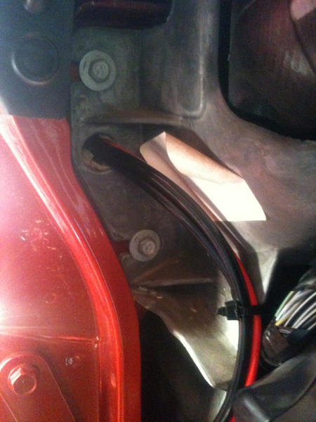

Ran 2 hoses and a power wire through the small hole..

Good job! Where are you planning on mounting the air tank?
I thought of mounting it on the roll bar on the back, but I dont like the way that looks when the top is off. I might just make a bracket and mount it on top of the sub box.
