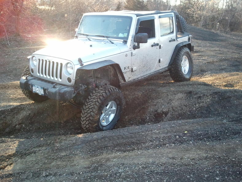

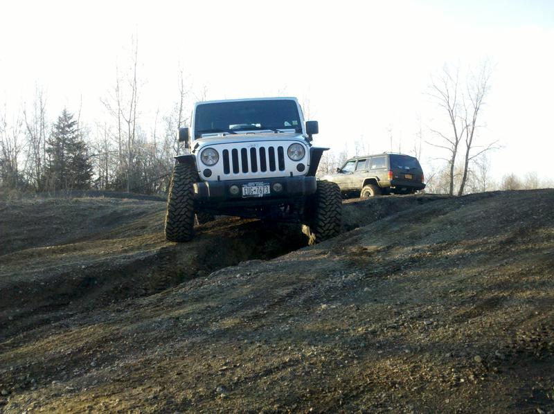

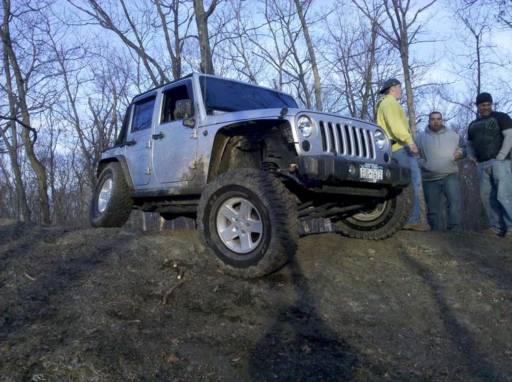

Disconnected front and rear with 2.5 pro comp lift 3/4 coil spacers in front trimmed rear pinch seam and cut about 2" off rubi rock rails no rubbing dana 30 3.73. My 5.13s just arrived today. This is my first jeep i can not believe what it will climb. Going up hills you can hardly walk up so much fun i have some videos im waiting for my buddy to send them to me.

so you only have 2.5 lift?

Yes procomp 2.5 tuned coil lift everyone dogs the procomp i love it gives a lot of lift. I added 3/4 coil spacers in the front to level it out, When i added the spacers in the front i had to get a adjustable track bar. When i get the gears put in, Im saving for 1" body lift and 40s for cruzin.

Another LCOG rig flexing. Love it. Can't wait to get some of mine up loaded.

37s and a 2.5in lift? that's pretty sweet. I guess i shouldnt have problems fitting 37 under my AEV 3.5 in lift then? with some trimming..
