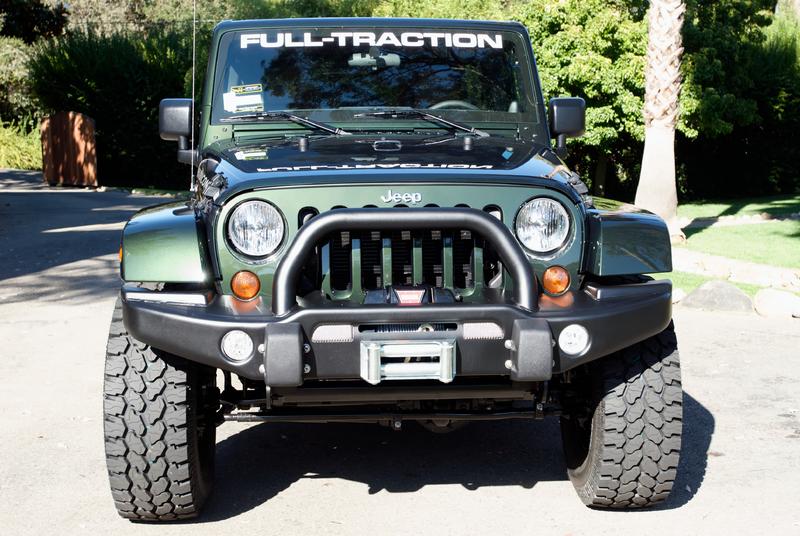

Looks awesome. Any issues installing the AEV front bumper?

Thanks for the complement, I spent a lot of time choosing the mods.
The AEV front bumper, was both easy and a challenge to install. The quality of the product is very high and everything fit perfect. You have a to drill a few holes, the one on the drivers side is a bit tricky. The vacuum pump mount weld on the front face of the bumper is dead center where you need to drill a 1/2 inch hole. So you are drilling into a weld that is on a 45 degree angle, takes a bit of effort to keep it on center. The winch mount has a bracket to relocate the vacuum pump, works great. If you read the instructions first and take your time, no problem.
Merlinn

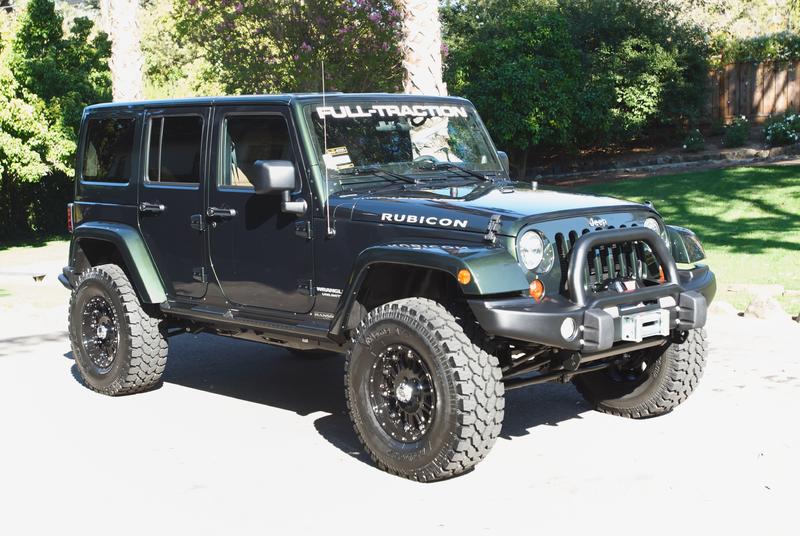

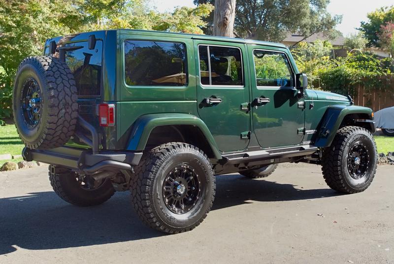

The color is Natural Green Pearl, which is no longer available..
I did not know how to attach the photos before so I will try again...
Name:	Jeep 3-4 front.jpg
ID:	217184   Click image for larger version
Name:	Jeep front.jpg
ID:	217185   Click image for larger version
