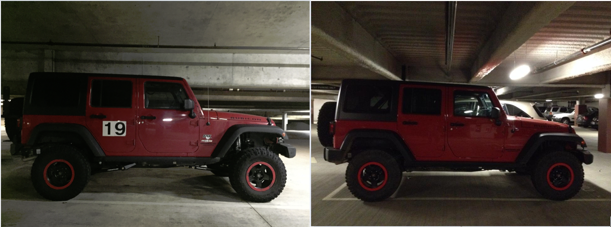

I decided to use TeraFlex LCG PreRunner kit and their Tera44 HD front axle for upgrading. Here is my first impression as comparing to stock Rubicon and RE 2.5 with Fox 2.0 shocks (call it RE.Kit) that I ran before:
1. Ride quality:
a. One road, this kit filters out small roughness on road very well. Both the OEM and RE.Kit response sentitively to even small bumps on road, for example, even the road markers will bring in a lot of vibrations to the cabin. The LCG kit performs extremely well on this aspect. Some forum posts say on road this kit drives like OEM, I would say much better.
b. Off road, this kit is no fear of potholes. Actually haven’t tried any off-roading yet but intentionally did fast passing some potholes in my neighborhood area, like nothing happened, this kit really is built for this kind of job.
c. On curves, body roll is more significant than RE.Kit but still better than OEM. I think the Fox2.0 is tuned stiffer. But I use adjustable Fox shocks with LCG, will see how to make it better
2. LCG kit levels out the front sagging, and opens up a lot of up travel space. It is said that this kit has 8 inches of up travel. From outside and inside, the car rides noticeably higher than on the RE.Kit, not to mention comparing to OEM. In the picture below, on the same tires, and with heavier rear bumper/tire carrier / winch, etc, the LCG kit still increases the height by 1”, so even if TeraFlex says this is a 3” kit, it is actually 3.5—4.0” depending on how heavy your car is.
3. The built quality of this kit is superb, and by looking I feel it is strong. I heard the joint TeraFlex uses have some long term reliability issue, I will see how it goes.
4. I don’t feel much difference from the Fox ATS steering dumper comparing to OEM one, don’t know if it is a worthy upgrade. Also, the rod is exposed, not sure if it can survive my Alcan trip.
