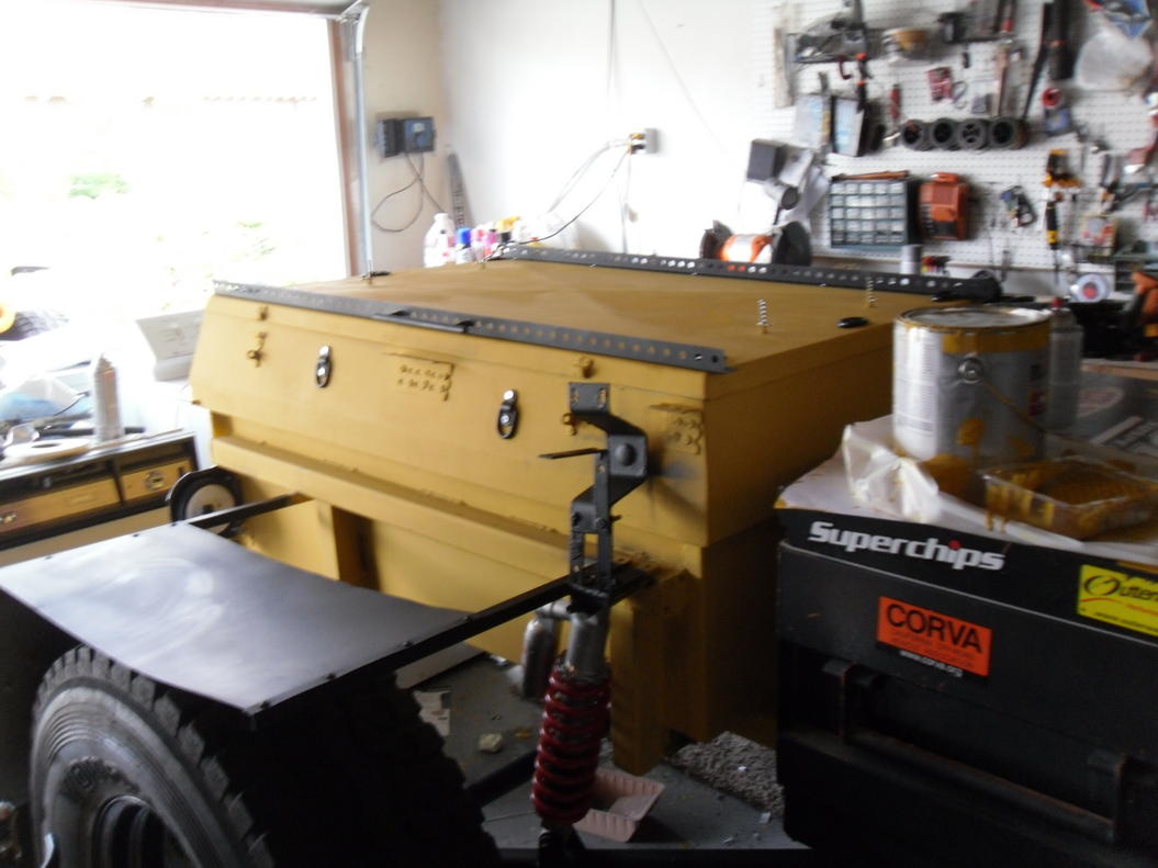

my challenge was to make something useful, functional, capable and cheap. It started from a kawasaki motorcycle trailer off craigslist for 200 bucks with 8" tires (gave those babies a 29" boost) got the coilovers from a trex off a desert race site for 200 and the tool box from my garage free. The hubs, bearings and spindles i ordered from pacific trailer in Montclair for 90 bucks. Another 100 bucks for hitches and pintle hook set up (HF). The rest came down to design and fab. I sold my 93 waverunner for some scratch to pay for that. Now I am trying to figure out what I want in/on it as far as bells and whistles.

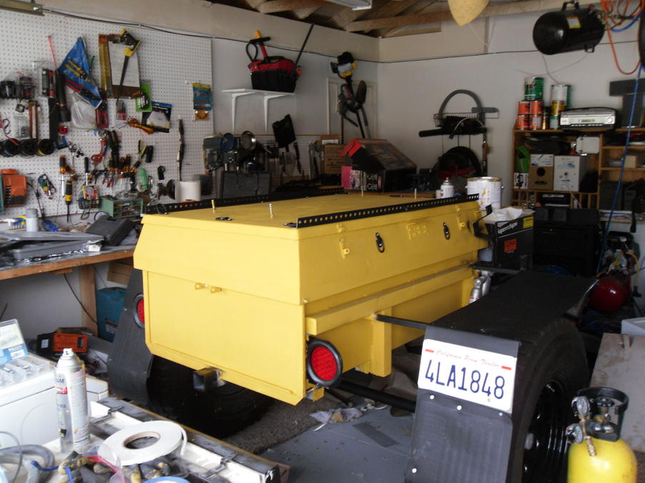

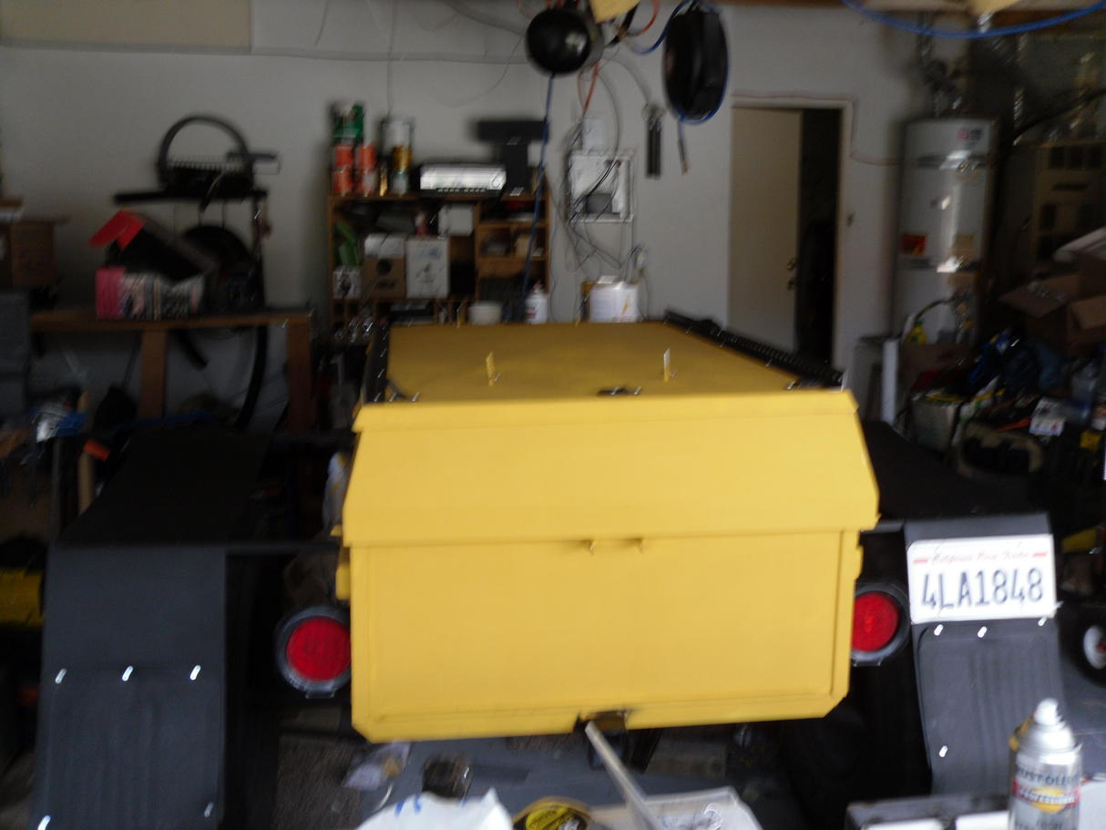

some more messing around today I used latex paint, hindsight may not have been a good idea, becaus4e I dont think it is going to harden completely oh well live and learn.

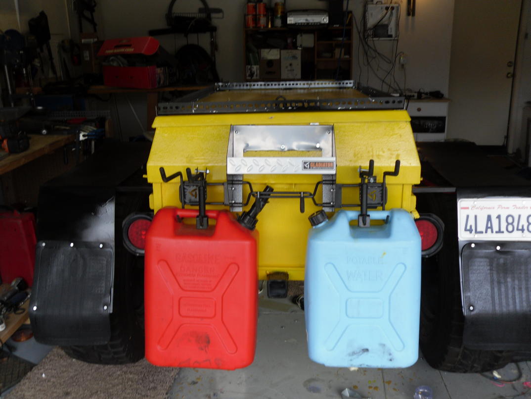

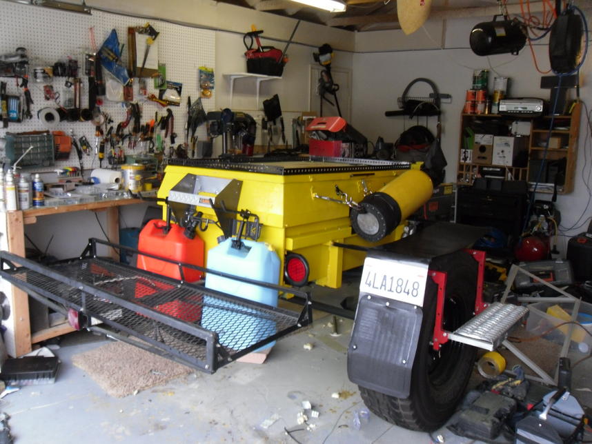

added a rack in the back that holds fuel/water and trash bags or whatever and a hitch basket for additional storage of firewood water jugs etc.
