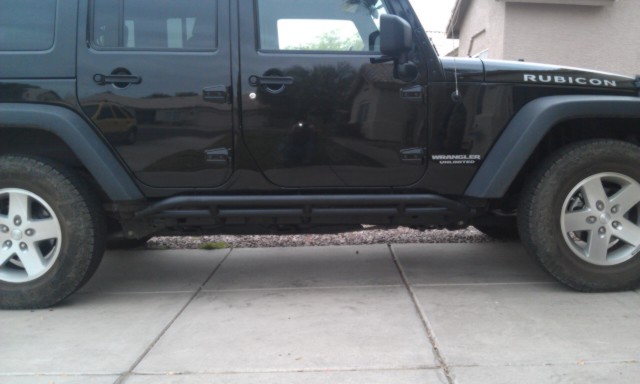

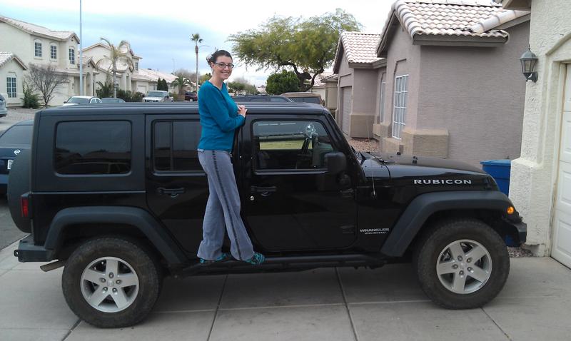

looks great.can you take a side shot.id like to see what it looks like from that angle.can you see the support pieces when standing beside it.trying to tuck mine like the poison spyder set. but these looks stronger welded to the frame like that
These are the best I can do right now, (at work), they are cell phone pics so they are not as sharp. Also my wife sneaked into one of them...

Perfect. Exactly what I needed to see. Looks great and you can relly see the mounts welded to the frame. That's what I was afraid of.

Not sure welding directly to the frame is the best idea with such a load put on such a small area something is going to bend or break eventually...especially if you get it hung up...flux core wire emits a shielding gas around the weld to keep impurities out while using a gas does the same thing it is a cleaner weld with the gas..much less grinding. A proper weld should not have to be ground any at all unless it is sheet metal where you need a completely smooth seam. The more wire you burn the better you will get.

The main benefit to a self shielding flux core wire is it can be used outdoors, and it does burn hotter than a solid wire such as er70 s-6 (MIG wire) with a C25 gas when running the same settings. With the right settings and joint fit up Mig wire will get as much penetration as a self shielding wire. There is no one wire that does everything. For building stuff such as this I would recommend using MIG and not flux core. Self shielding flux core wire is a farm wire. lol
Also I would NOT weld to the frame. Never weld between the suspension mounting points on a stock frame which is a tempered material and welding to it changes the structure of the metal and can cause frame failure ...... bad bad bad.....
