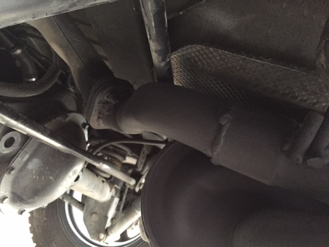

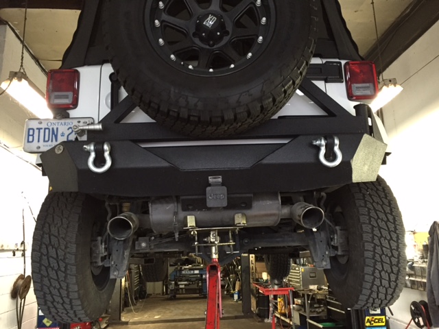

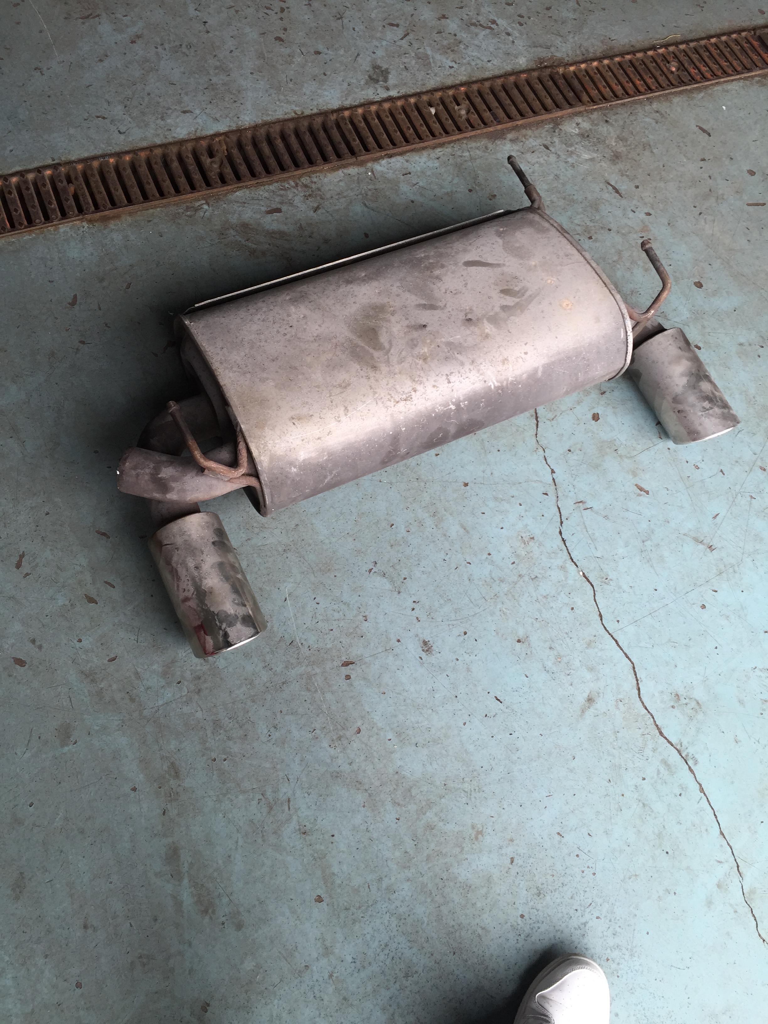

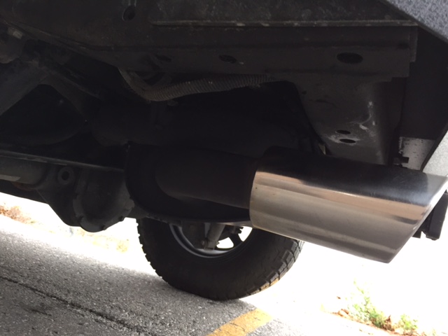

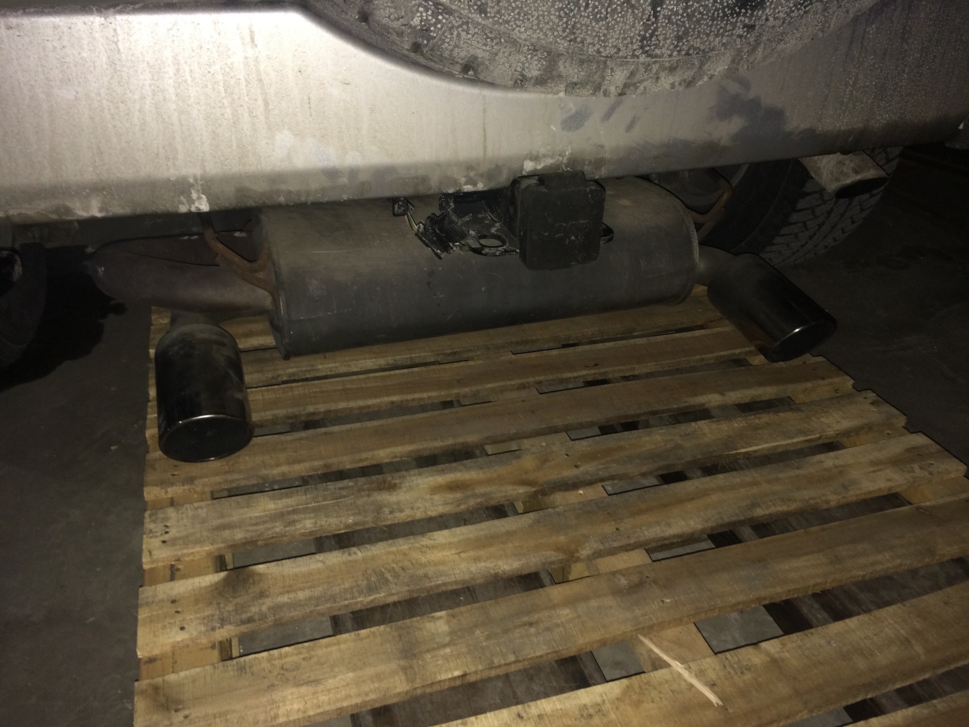

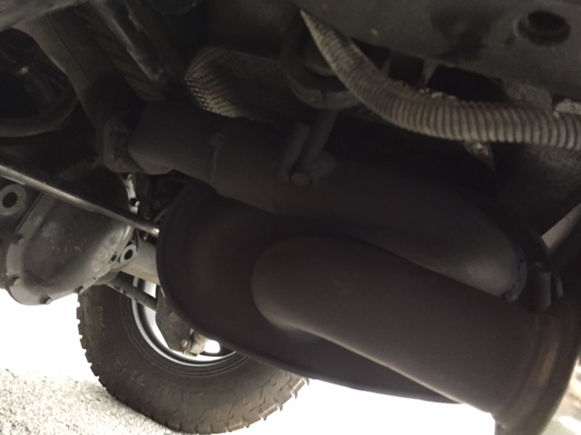

Here another mod i've completed.
Slapped on a nissan 350z muffler on my 14 jeep jk.
the guy who installed it did a pretty good job.
He extended the hangers on the 350z muffler cut the pipe and redirected it properly adding a flange.
And didn't touch my factory piping, or hanger positions. only added a flange to the factory pipe.
So anytime I could go back to stock or bolt on aftermarket.
Happy with the result.
