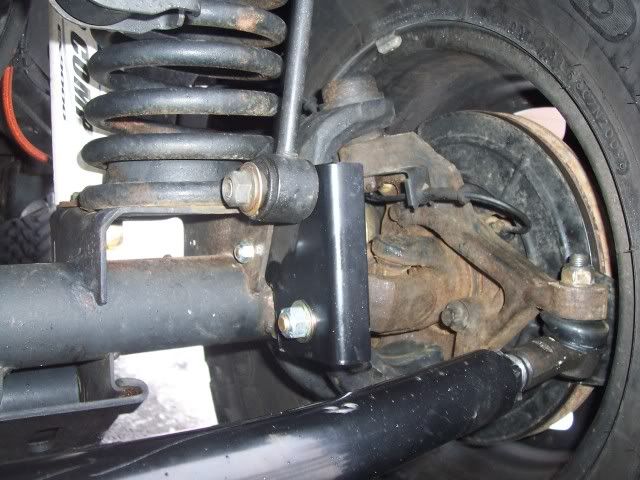

Here are some pics of the install. Still waiting on my Teraflex steering stabilizer.
Beefy TB bracket:
Flipped drag link:
Driver side sway bar link relo bracket:
