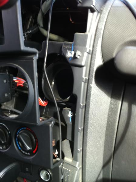

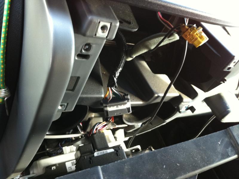

Ive taken apart my dash and painted the gray console accents
You will first need to remove the vent/ac rings, then remove the top part of the dash (where the daystar panel goes) pull the center dash out, then unscrew the stereo, then you can remove the gray accents
