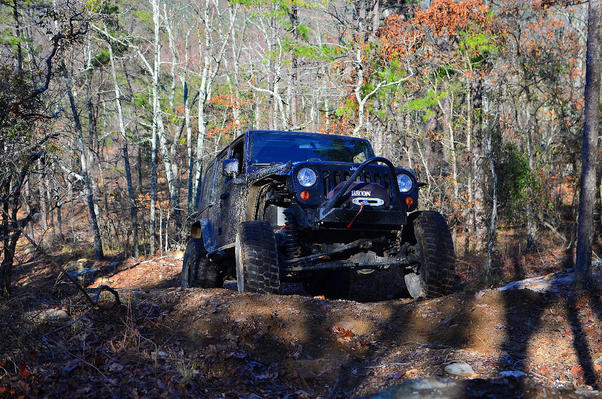

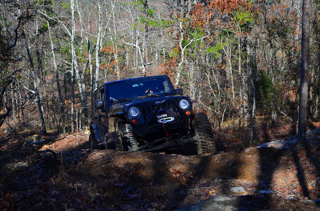

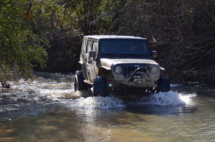

37" BFGs on a 3" Rusty's lift. Trimmed the fenders, pinch seams, and Rubi rails. I need to add a little to the front bump stops.

Any rubbing issues? I run the 3.25" and have contemplated cutting the fenders and going with 37's

Just a little at full flex. I haven't measured exactly how much I need to add. Going to do the Smitty XRC fenders in the front so hopefully that will solve some of the rubbing.
