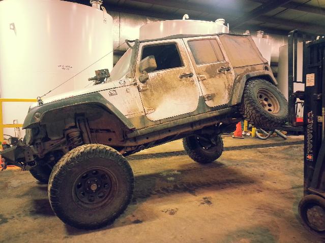

For a while now i wanted to start a build thread. I could never figure out where to start with it. So i guess we can start with the beginging of where it all started.
My jeep is a 2008 rubicon with tow package and 4:10s.
It came and within 2 hours i had this lifted and out on 35" dunlop rover mts.

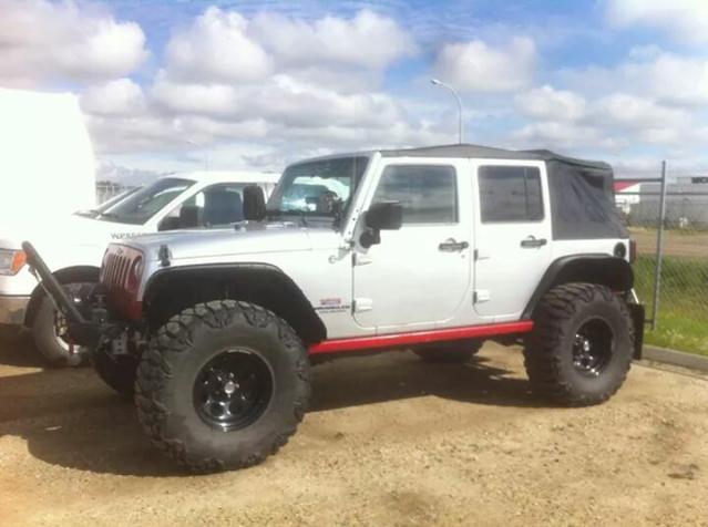

I had these on for a while but again i couldnt handle the power loss. And decided 37s were meant to be.
37" bfg ats are still till this day my favourite tire.
And this is how it sits now.

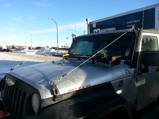

I made limb risers out of cable that was given to me. I had my lightbar stolen and had brackets sitting there i had the lightbar for 2 and half weeks.
And did i ever love the look.
Anyways i bought eye lit bolts and turn buckles ( that still need to be installed )
It was about 25$ by the time i was finished and keeps trees from hooking my high lift jack and pulling up on my hood.

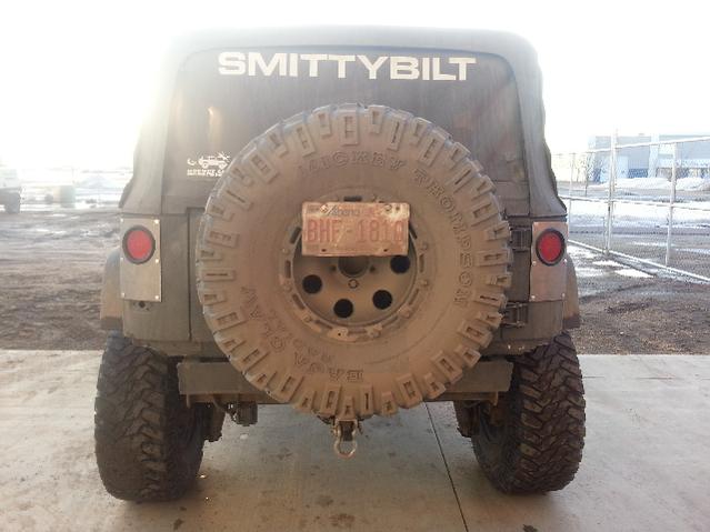

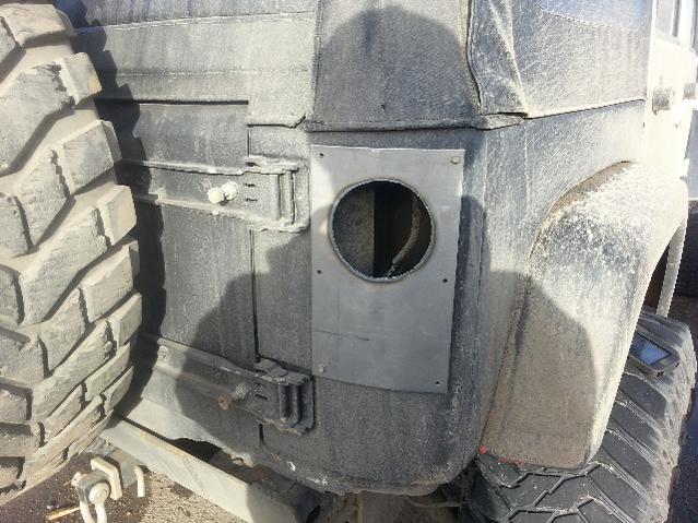

I had 1/8 steel rolled and a 4 1/2" hole cut for my tail lights after slidding into a tree lol
They didnt even charge me for the plates awesome!
They are riveted on with 3/16 aluminum rivets using grote 4" led tail lights.
My back up light is mounted inside the tire carrier.

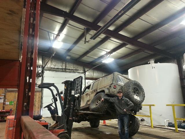

I found a old set of 11r 24.5" triples at work that i am going to shorten and cut in half and use em for those days where nothing will get me out. ( i hate asking for help )
These seem to be 7mill, ill make sure to do a write up on them. Whenever i decide to shorten.
