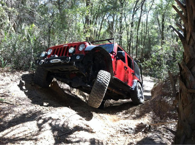

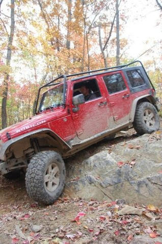

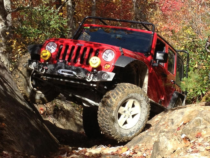

I ran them on a leveling kit for almost a year. Two inches of lift will work great on the road. You will need to trim the fenders or get longer bump stops if you do a lot of disconnecting.
ID:	490176   Click image for larger version
ID:	490177   Click image for larger version

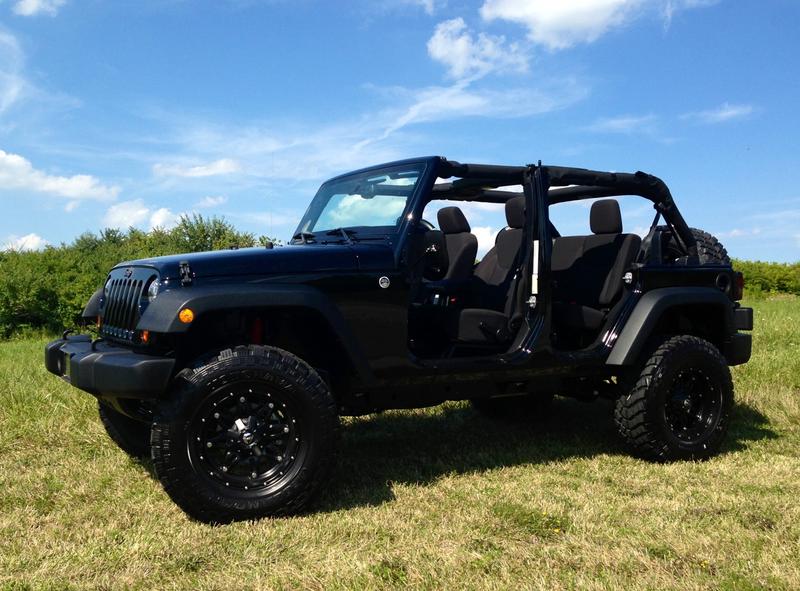

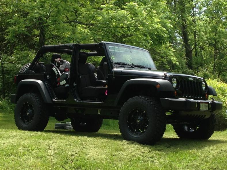

2013 JKU
3.5 Rough Country lift
17x9 Fuel Hostage wheels
35x12.50 Yokahama Geolander tires
hard top and Trektop NX
rock nob shifters
...and plenty more to do when money starts growing on trees!
