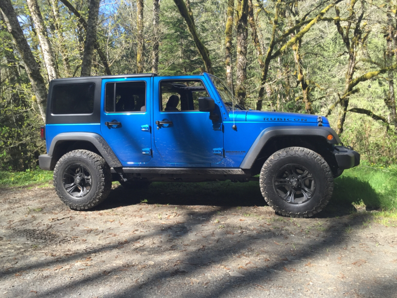

18/59 coils, Rubi shocks, Teraflex puck kit 2" in front and 1" in rear. Runnings Rubi take off wheels and tires. <img src="https://www.jk-forum.com/forums/attachment.php?attachmentid=644449"/> <img src="https://www.jk-forum.com/forums/attachment.php?attachmentid=644450"/>
did you add any other parts to your lift or did you just swap springs/shocks and add coil spacers?
That is it. Just running Spider adapters. I have some TF shock extensions I might throw on. Very happy and everything slightly used and been running most of the 99,000 miles on it.
I'm on the fence with 34 or 35's and might change my shocks out for shocks for a 2" lift down the road.

IF you want to go 35. add the teraflex body lift. If you want to go 37s add the body lift and mopar fenders. Your awesome suspension stays the same, you have enough clearance and save a pile of money.
I am also thinking of running with cut flares or flats and then add some bump stops if I go with 35's. Definitely, a very inexpensive way to go.
