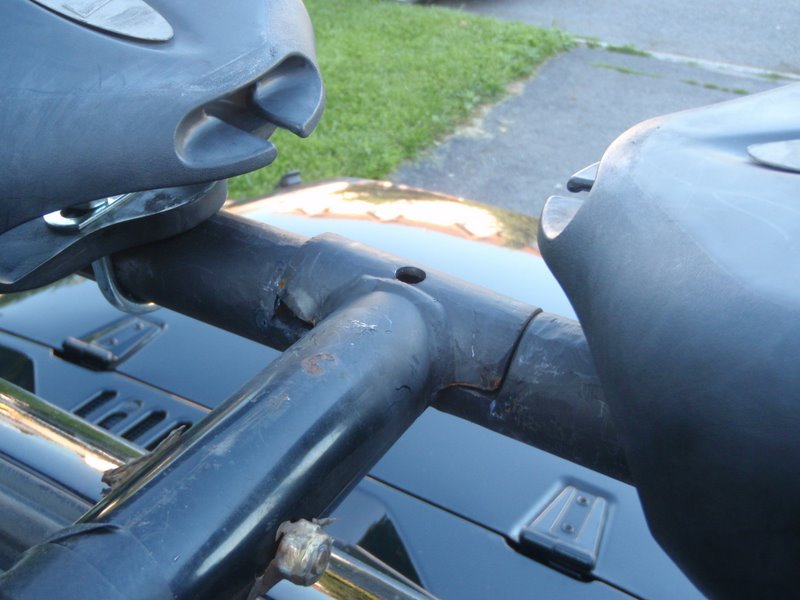

Here is the front bar, after my friend cut out a small T shaped section and welded it up.

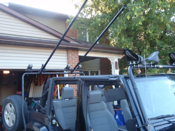

Here is the Congo Cage split and lifted to allow me to raise my soft top. Without the weight of the front frame I can just grab the rear and pull it allowing the bars to lift. I then use a strap to secure it out of the way while I raise / lower my soft top.

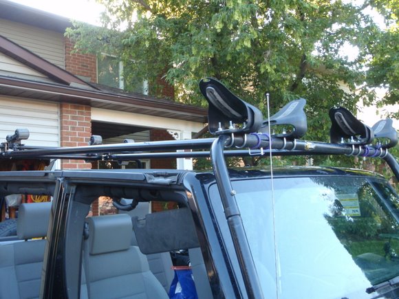

And here in the Congo Cage when it is locked into place. I have one pin on each side securing everything and I have a bungee cord to prevent it from rattling.
I wish the Congo Cage had of come like this from the factory. I realize that my modification probably reduced the amount of weight that I can carry, but I am only using it for my kayaks which have a combined weight of about 100 lbs.

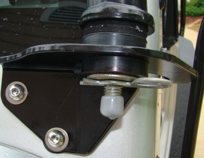

I just ordered and received my new CONGO CAGE from Quadratec and installed it this past weekend. One thing that bothered me the most was that I couldn’t quickly put the top down with the canoe rack on. So I modified it…too bad I didn’t see this post first, but there is more than one way to skin the cat…
What the picture doesn’t show in detail follows:
I used at ½-13 threaded rod about 4 inches long and secured it with a jam nut. I fabricated a rubber washer (top washer right below the support arm of the rack) to dress up or hide the jam nut. I then drilled a hole into the threaded rod for the pin. I works great as is, but I will also put Nylon Insert Lock Nuts on if I’m actually transporting my canoe just in case.
