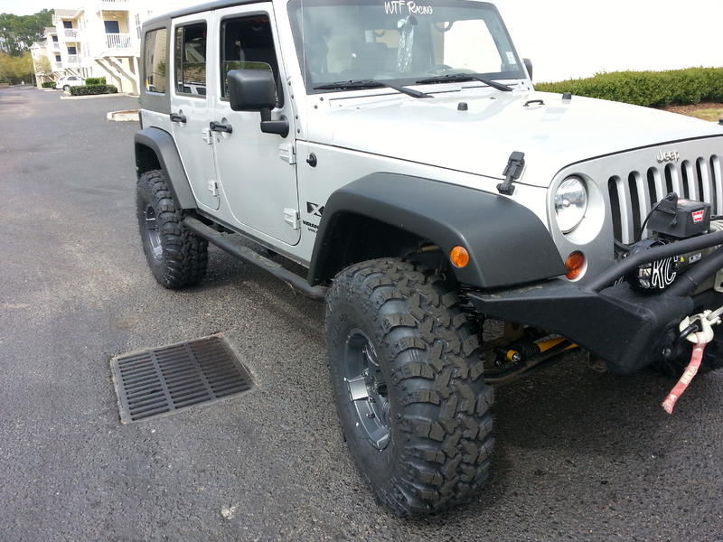

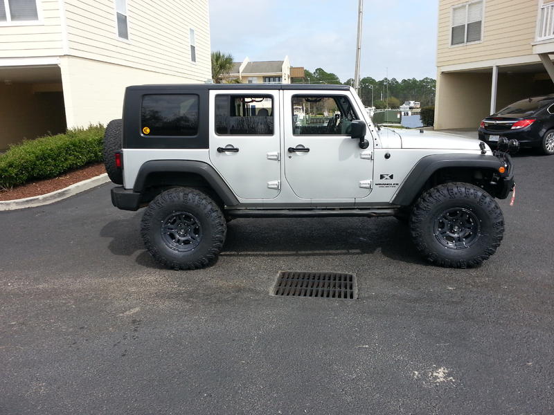

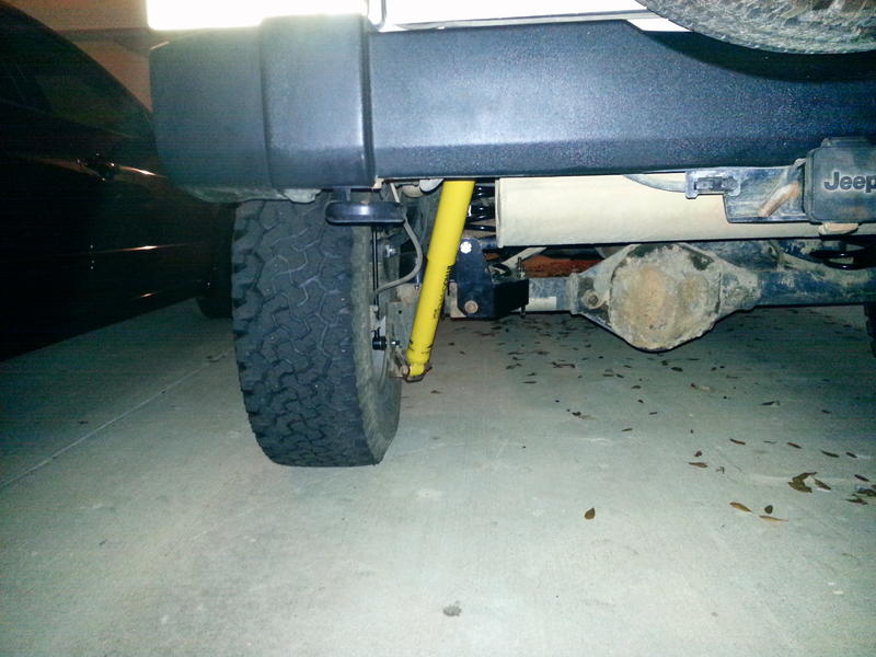

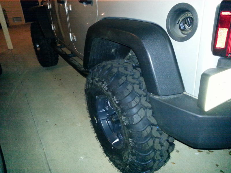

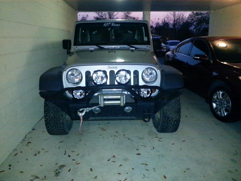

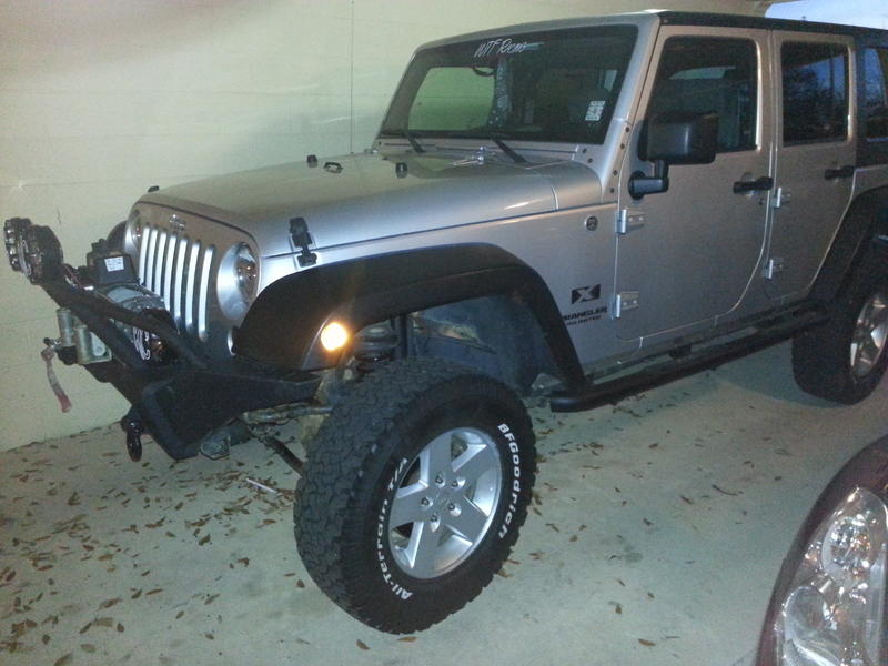

Hello I recently started building my jk. It will be a slow process. I just put a ome 4" suspension lift on it this past weekend. My 1" m.o.r.e. body lift will be in this week as well as my rims and tires.(atx artillery Teflon 16x9 wheels with 36x13.50 r16 super swamper irok tires) I'll upload pics when I get them in. Im still trying to figure out what control arms im going to get. Well I'll add to this as I go. Thx before lift Click image for larger version
ID:	541925Click image for larger version
After liftClick image for larger version
ID:	541927Click image for larger version

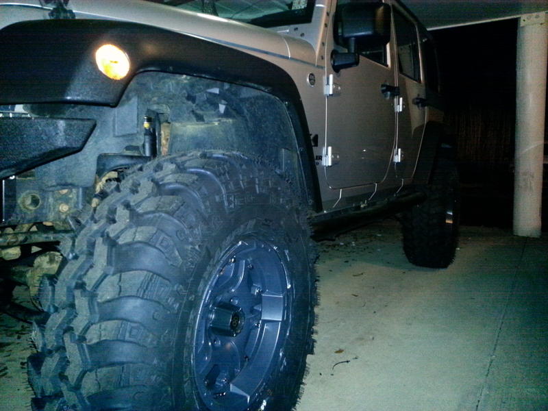

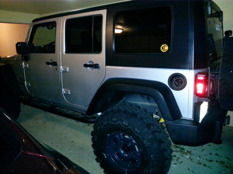

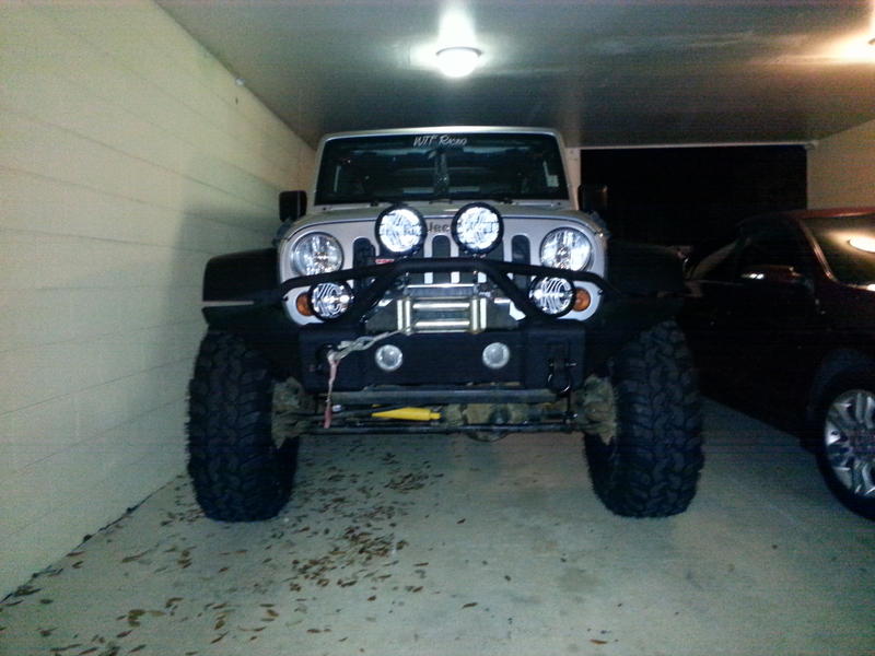

Soooo happy! I got my wheels and tires on today!!!! Ill take some better pics tomorrow
ID:	542651Click image for larger version
ID:	542652Click image for larger version
ID:	542653Click image for larger version

I would be very concerned about both your front and rear sway bar links. Steering geometry would be worth looking at as well.

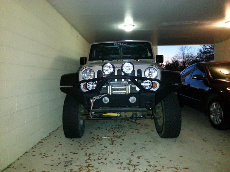

ID:	542850Click image for larger version
ID:	542853Click image for larger version

Looks like you could use a full set of control arms as well to regain your wheel base.
Old Apr 2, 2014 | 07:22 PM
bsweezy's Avatar
Joined: Mar 2014
Posts: 11
From: south Mississippi
Yea I've been looking at them. As I said above I haven't been able to settle on a set. Any suggestions would be very helpful.
Old Apr 2, 2014 | 07:58 PM
TheDirtman's Avatar
Posts: 6,222
Likes: 376
From: Southwest Reno, NV
I would not be as concerned with the brand arms but the joints they use, although some are bent to give added clearance. It really depends on what your needs are and what you do with your jeep.
