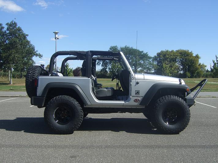

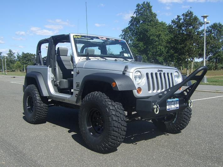

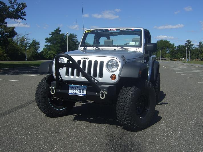

cragar 15x8 soft 8's
35x12.5x15 BFGoodrich mud terrain KM2

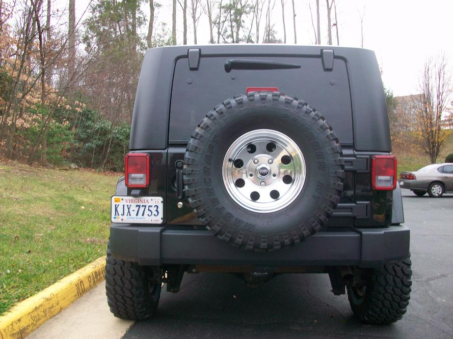

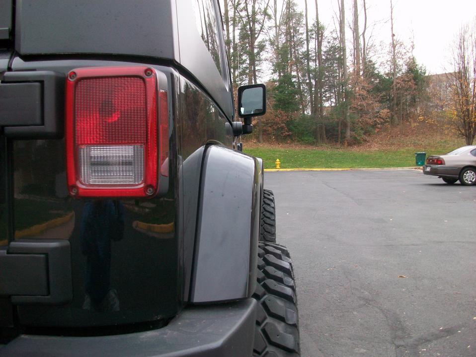

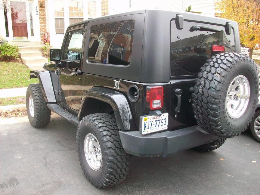

Here is my JK with a 2" spacer lift and 33x12.5x15 Mastercraft Courser MTs on 15x8 American Racing Baja wheels. I had to put Spidertrax 1.5 spacers on to allow the wheels to clear the brake calipers. They are 3.75 backspacing and -19 mm offset for anyone who is curious.

Jeep looks great but not a lot of backspacing after you put on those wheel spacers. You're now down to just over 2". You'll end up going through hub bearings and gear boxes fast.

Not true. A modern wheel spacer with bolts of high quality has no different effect than running a wheel with more backspacing. Look up what wayolife says about it on the wheel spacer thread. He knows his shit. Trust me. Thanks for the concern though. I suppose the other option would be to grind down the brake calipers to make the wheels fit. The old school spacer that were sandwiched in between the wheel and the hub caused more problems like that and were known to fall off as well.
