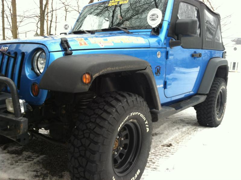

He is mine 2.5" RK Max Travel, 15x8 Summit Racing series 164 aluminum wheels, and 35x12.5x15 Falken Rocky Mountain ATS tires.

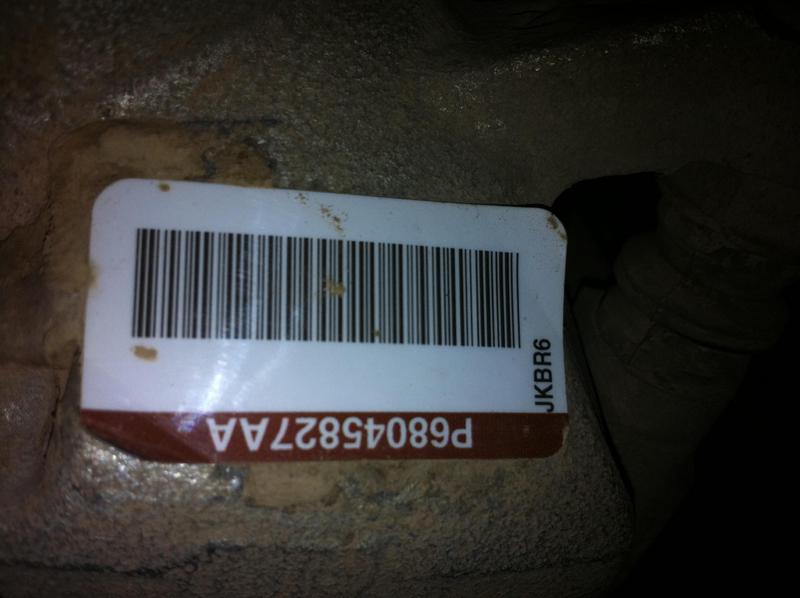

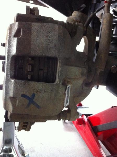

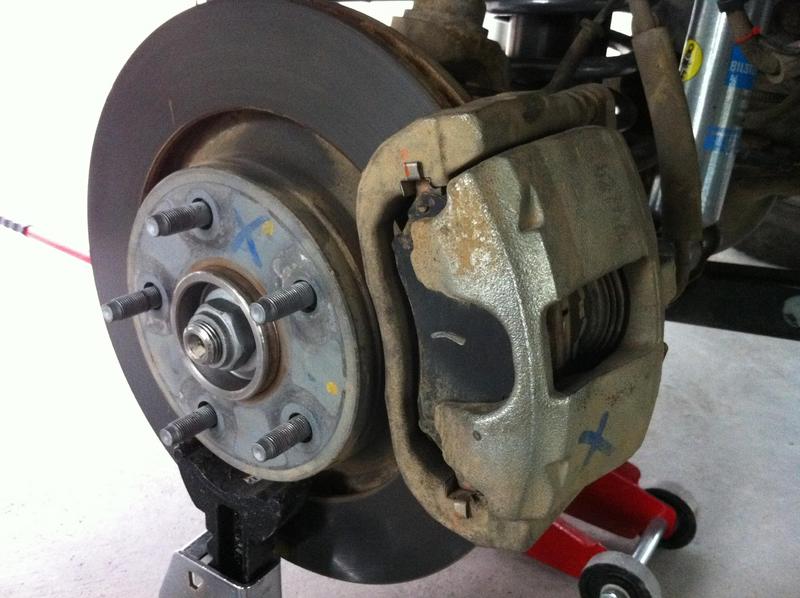

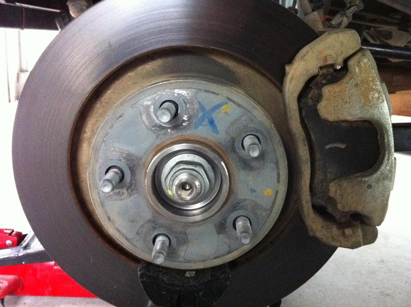

I have a 2010 2 door rubi with D44 front. Export version.
In the pic below shows my front driver side break. The part number of the caliper is Driver side_ P68045827AA, Pass Side_ P68045826AA..
Can someone pleas tell me what do I need to change if I want to fit the 15" like you guys.
If you can give me the part number, it will be great.

I thought all of the brakes on the JK's where the same you just have to get a wheel with the right offset.

Are you saying your calipers are bigger than others?

A rim 15x8 x 4'' back spacing might rub slightly, but only for a few seconds. Yes, I'm suggesting you put it on and drive to grind down the rim rather than cut the caliper.
If you go 3.75" BS, it'll clear beautifully.

yes, the rotor is 13 or 13.5 inch. I think I need to change to the smaller US version caliper and the 11 inch rotor, but what about the caliper mounting bracket. Do I need to change it also? Does anyone have the part number for the caliper mounting brackets.

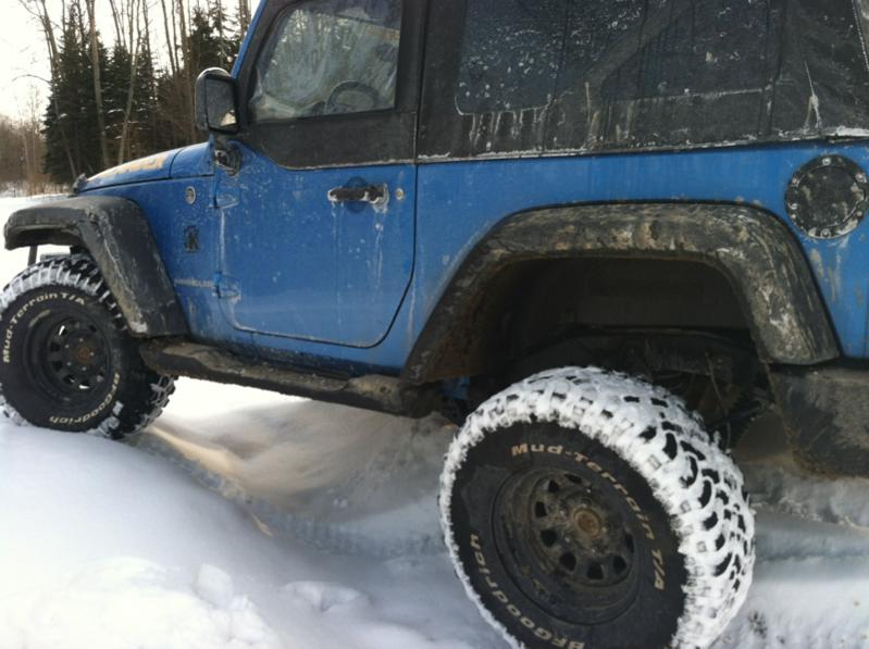

My km2 33/11.50/15 and km 33/11.50/15 on pro comp series 52 15x8 and 2.5 rough country coils and pro comp shocks
