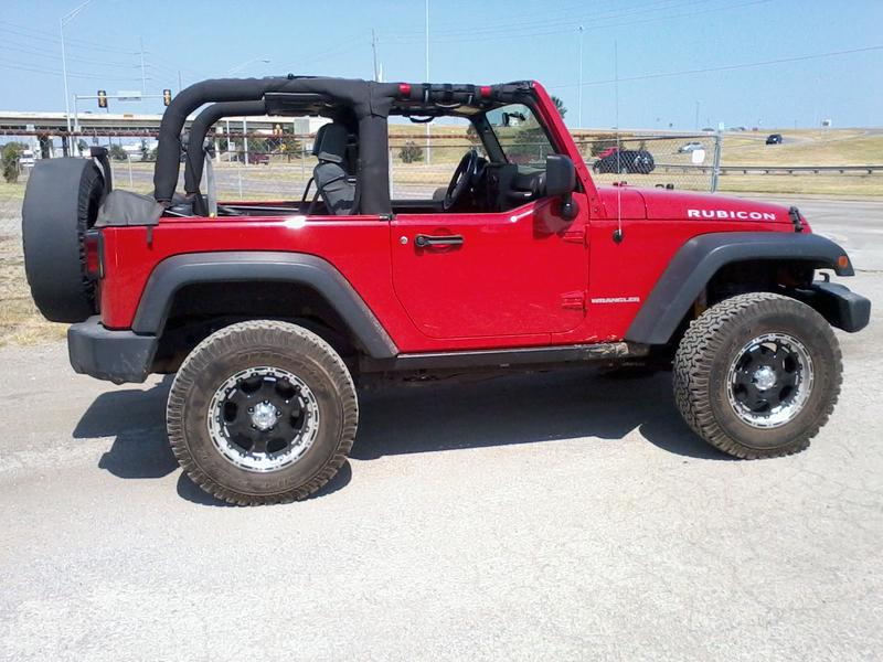

OME HD. Still waiting on rear lod bumper so expect 0.5 drop in rear after. 33 tires measuring more like 31.5

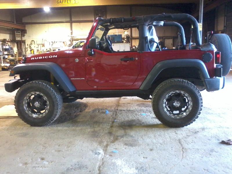

Default 3" OME with 33's
I got the Northridge OME 3" LT kit. Just put it in Friday. I ended up with 3.7" lift
