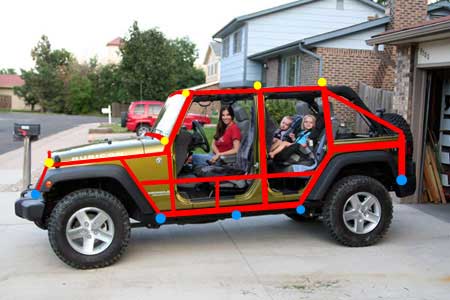

Wowsers, that is a pretty cool rendering. Mine won't be anywhere near as snazzy as that one!

Okay, so here is what I was thinking. I wanted something that would ONLY protect the JK when I'm out on the trail. Typically in the summer I have the top down and the doors off. (as you can see, the doors can't be attached unless I want to climb in/out through the windows)
The blue dots are where the cage would attach to by bumpers/rock sliders.
The yellow dots are where the cage would be separated for storage. The two sides would be welded together, and the cross tubes would detachable.
Or at least thats what I was thinking about.... With this design it might not be the best for a hard roll-over, but it should definitely help in a side-roll as well as protecting the body against rocks.
