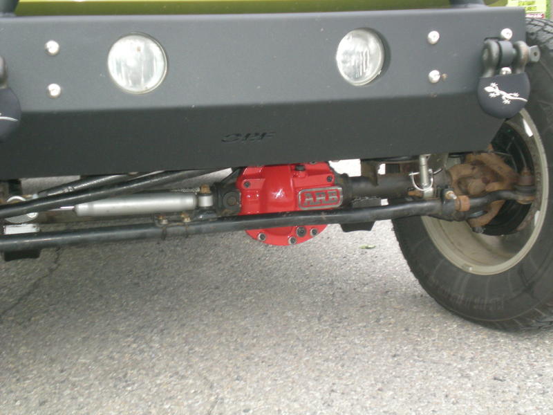

I have a 4door JK, running 37/12.50/17 Falken Rocky Mountain ATS, have approximately 40K on it with no issues. I'm running 4.88s in the rears, my dana 30 diff is open, The only beefing I did to my dana 30 are C-gussets, poly performance heavy duty ball joints, lower control skids, and ARB covers.
This pick was right after my gears were done and just before my 37s went on.

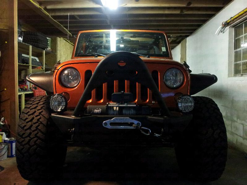

Sry only pic I have and I'm out of town in my other ride

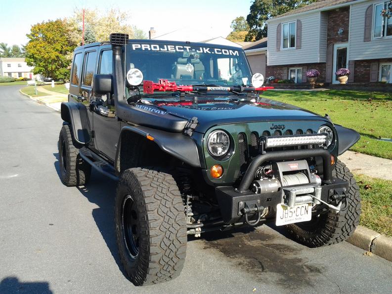

This was my 2010 JKU Sahara with stock gears (3.73's) 4" Rancho long arm suspension lift 37X12.50R18 BFG KM2 tires..... Rode just fine.... Lil sluggish on the hiway but it's a jeep.... Whatcha expect lol.... I rolled that, now I have a 2010 JKU Rubicon with 4" Skyjacker lift and 315/70R17 Goodyear Duratracs, I liked the 37s on the Sahara with 3.73's so as soon as my Duratracs wear down I'm going with 37X12.50R17 Goodyear MT/Rs!
