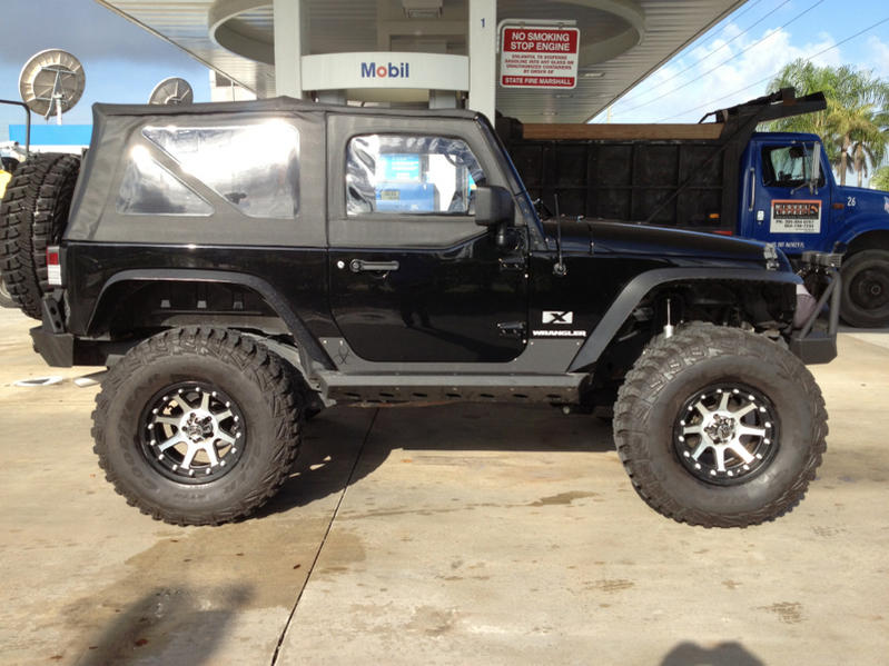

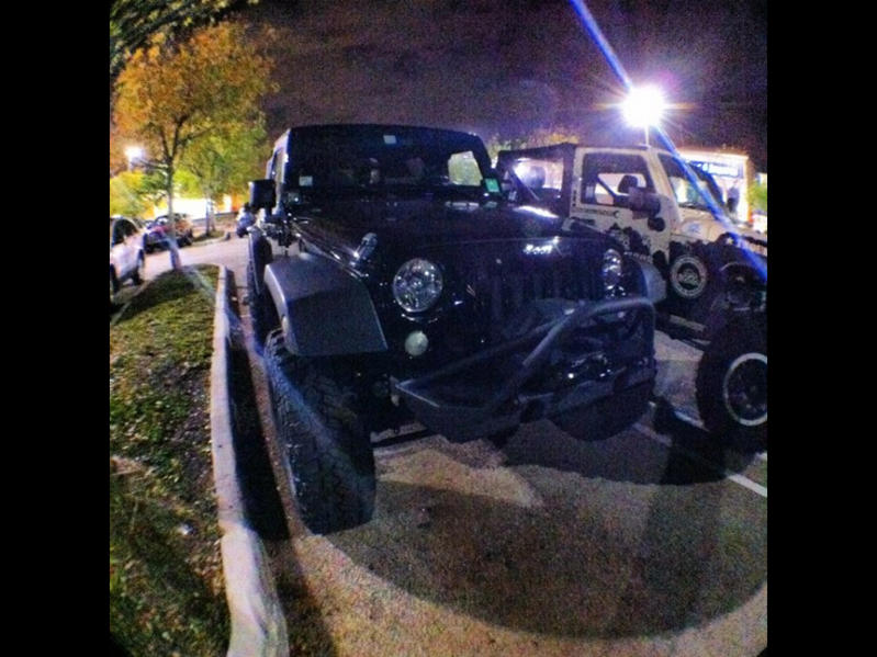

My D30 is geared to 5.13's, sleeved, gussetted, auburn electric locker with MTR's w/Kevlar 37" which was on stock rims until I upgraded to xd addicts. I've got Poly ball joints too but I've gone through one set with another upper going bad now. Other than that I've been fortunate, as I haven't broken anything. Although I personally believe the lockers help. It allows me to crawl over stuff otherwise I would be spinning and going faster than I should.
