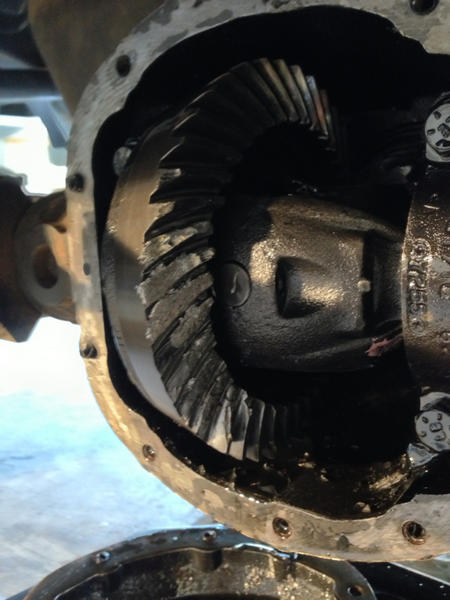

So I pulled apart my 30, thinking it was my spider gears again, but this time it wasn't, it was actually my r&p. which, if you gear a 30 that low, the Chances of that happening increase, and mine did. Again, only on 35's.
As far as changing shafts out, it usually simple to do, but there could always be complications, depending on whether you broke the outer, or I towards the differential. The TJ rear axles had c clips holding them together, jks do not. THe axle wont walk out on you front or rear

This is what makes the D30 so weak. The size of the r&p
Yeah it just sheared the teeth off.
did you set it up yourself or have a shop do it? just wondering cuz most guys that do it themselves seem to take there time and do it right. where a shop gets it close and gets it out the door.

Did it myself with a few other guys, and these have been in for over 40k miles. We've done many sets in several different jks. But as the above user posted, that small of a r&p, and doing anything more than mild wheeling, it was bound to happen sooner or later.

The D44 has a larger ring and pinion than the D30, which is what makes it stronger. Lower ratio gears (more teeth) also decrease the strength and are more prone to failure. Much of this depends on how you drive it
