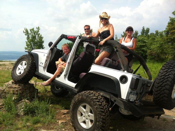

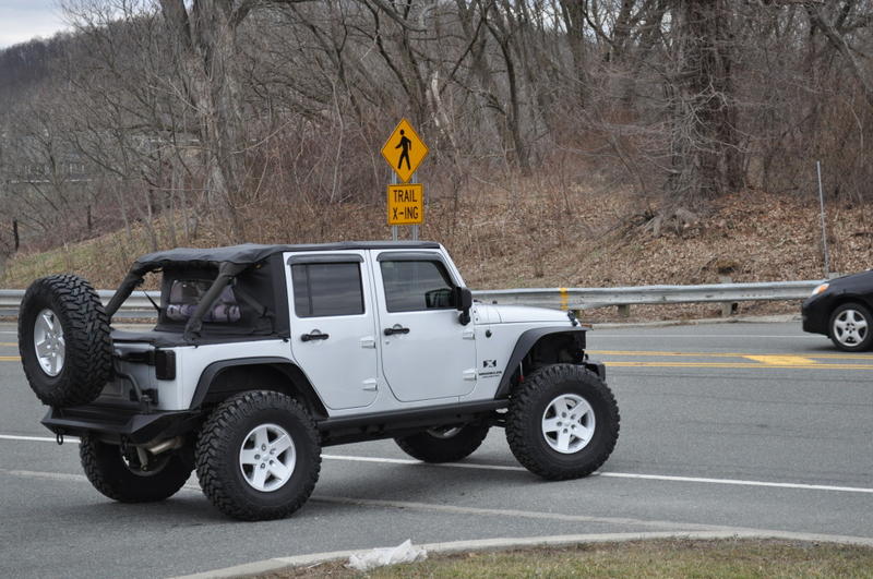

I ran the 2.5 procomp on my 09 jku great lift for the price. I ran 37/12.50/17s with 3/4" front spacers to level it out 2 1/2" bump stops cut my fenders and trimmed in the rear wheel well.
The last picture is before i cut the flares and added the spacers the tires are 315/70/17 its a small 35 though.
Attachment 297688
Attachment 297689
Attachment 297690
O yeah don't worry i won't settle much i was running a fabfours rear bumper and a front bumper with winch and didn't sag much at all 20,000 miles
That looks great, if I had it all to do over again I'd get a JKU instead. Thanks for the reply
