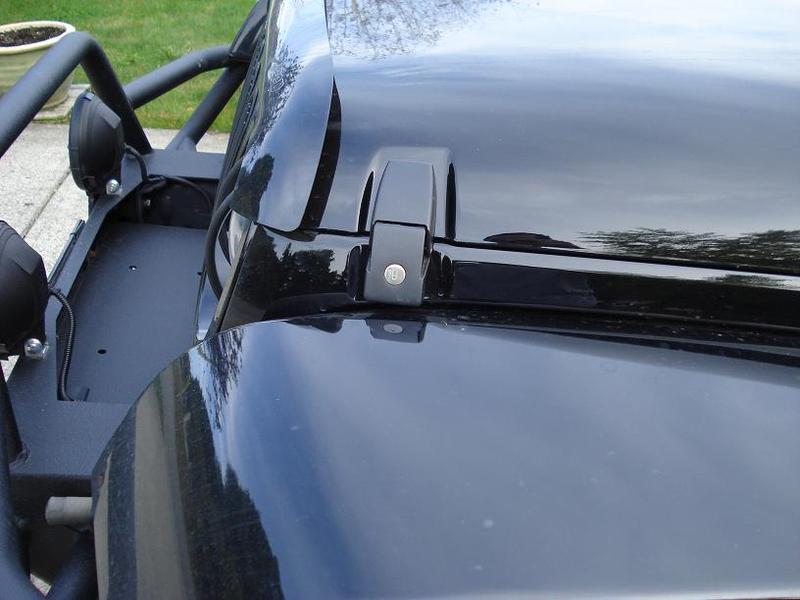

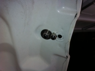

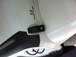

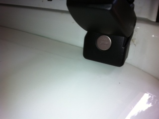

Note: These do not work with the Xenon Flares without some modification.
I had them on then tried to latch the hood and they were stopped by the flare because it is raised a little more than stock.
I had to drill a hole just above the stock hole on the body and one hole just above the stock latch on the hood. They work great and when adjusted properly they hold the hood down very well. I had a Rugged Ridge hood lock but it was a PITA to use. So I replaced it with this one. Here are some pics:
