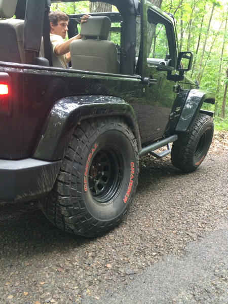

I'd definitely recommend the Flashpaq too. It really helped give a little power back with stock gearing (3.73). Plus I get around 18+mpg in the summer. Flex is about the same I'm assuming since I never flexed stock. I just have the shock extensions now but am upgrading shocks in the near future. This picture is with no bump stops either.

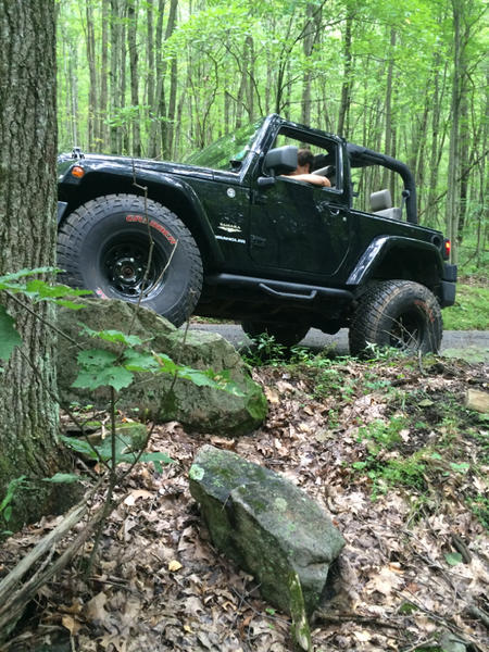

This is from the front then
