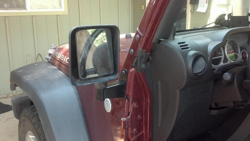

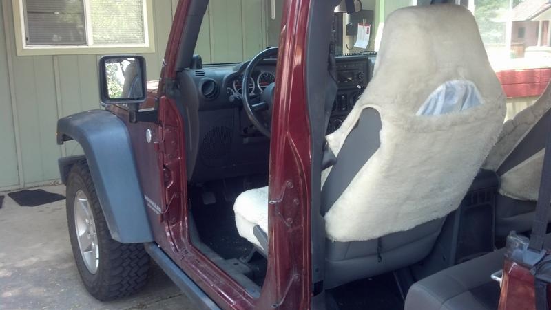

Pictures of the Rugged Ridge mirror relocation brackets after installation.
Very easy to put on, they look pretty cool, and I havent noticed any vibration, but Ive only been on the hightway, since I just put them on. Hopefully I will be able to hit some trails this weekend and really put them to the test.

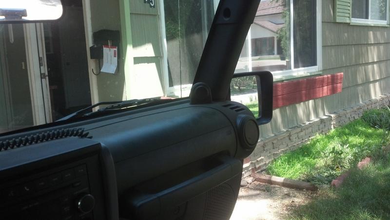

My only complaint, and I honestly may them them installed incorrectly, is that the passenger side mirror doesnt provide much of a view because the wondow pillar is in the way.

You have not installed them incorrectly. The lack of visibility out of the passanger mirror is the most common complaint about this product.

I had Em on my 2door and with the doors on you only get 50% of the mirror. But like someone else said, that's the trade off for not vibrating. Those things are solid. I have Olympic safari mirrors and the vibrate like a MoFo. They verge on being truly useless.

When I'm doorless, I only have the drivers due mirror. That's legal (cars didn't used to even offer two outside mirrors years ago). As mentioned above, the passenger side bracket location is basically useless. This way I have good visibility with doors on, which is how I drive on the street most of the time.
