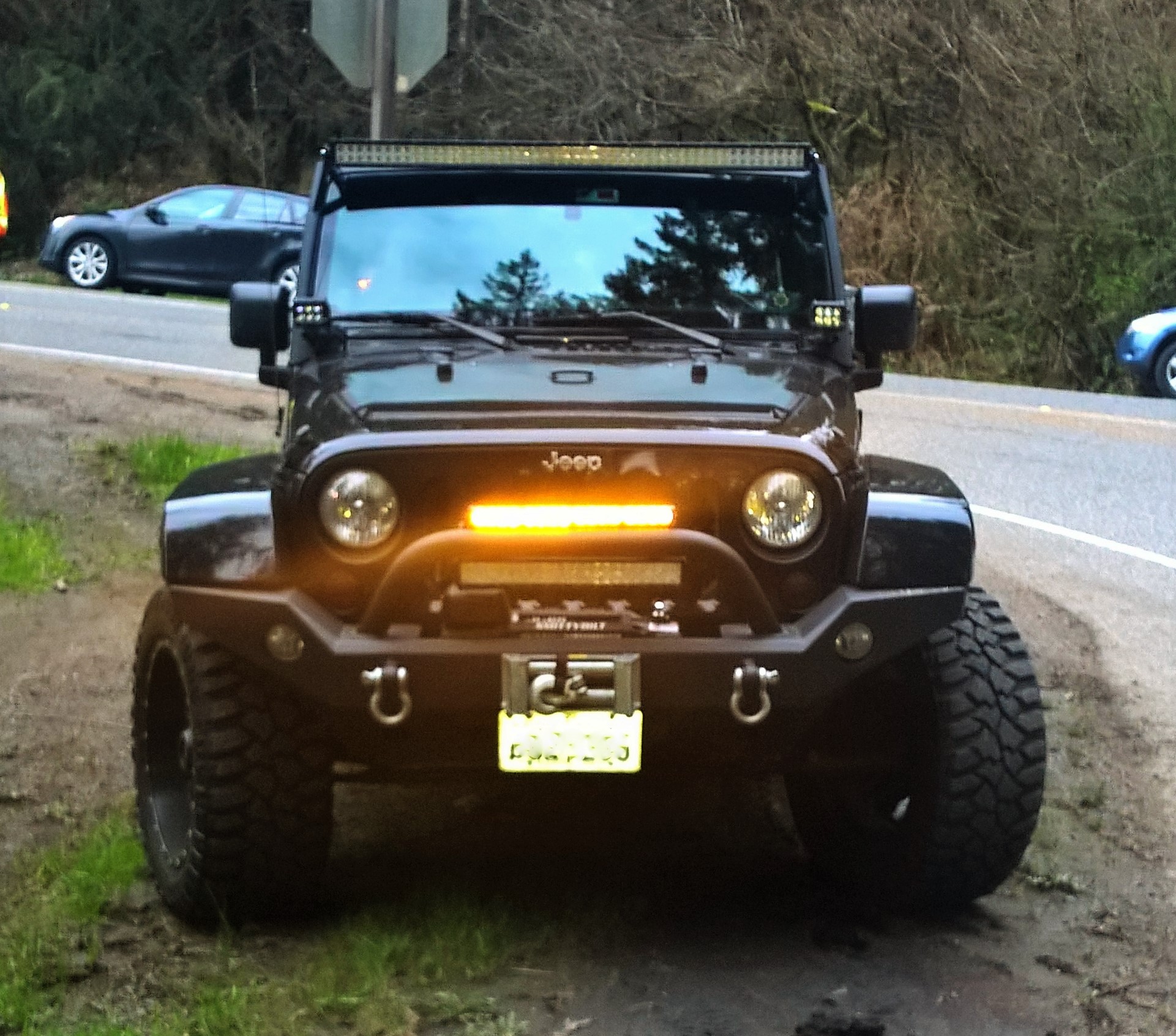

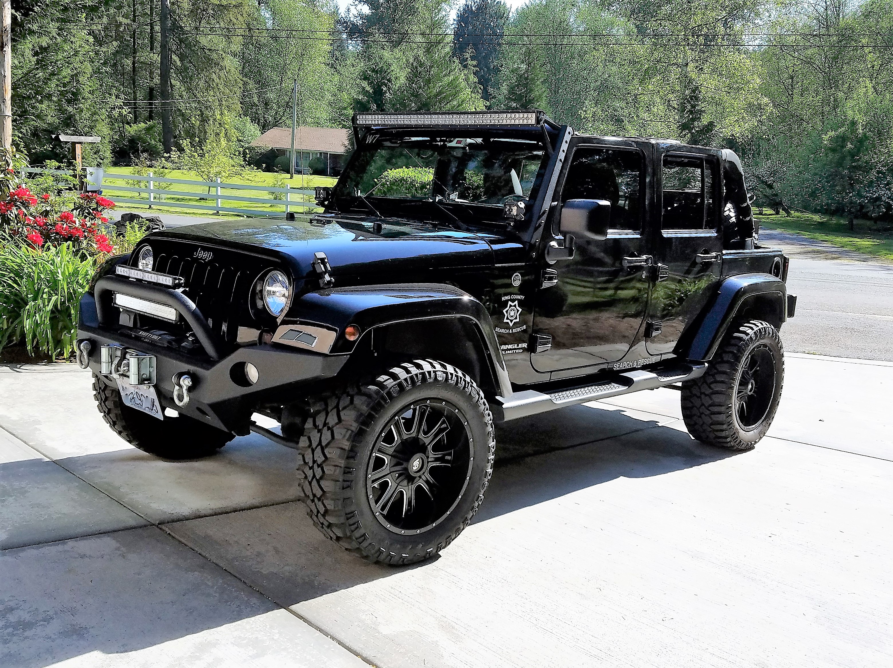

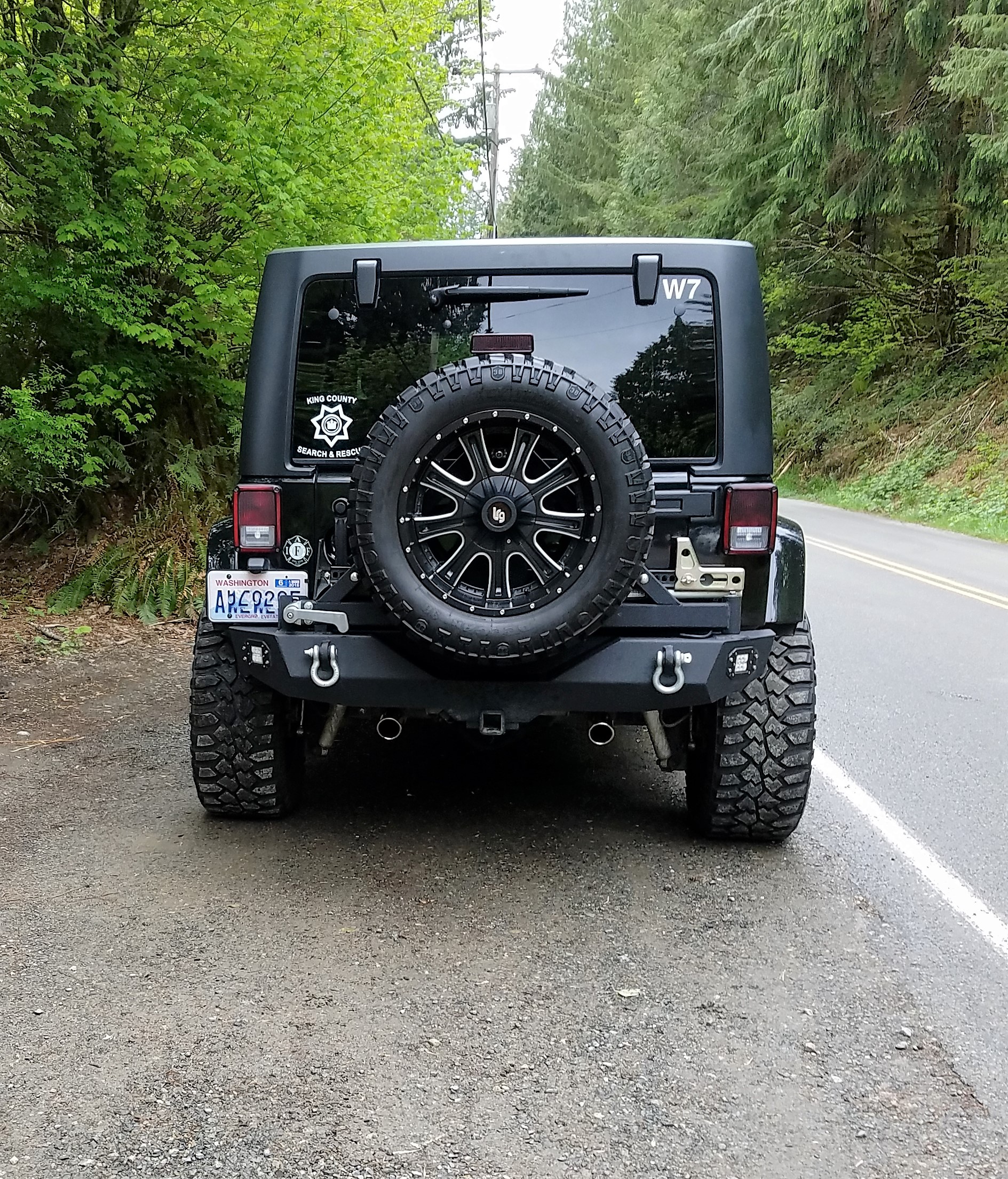

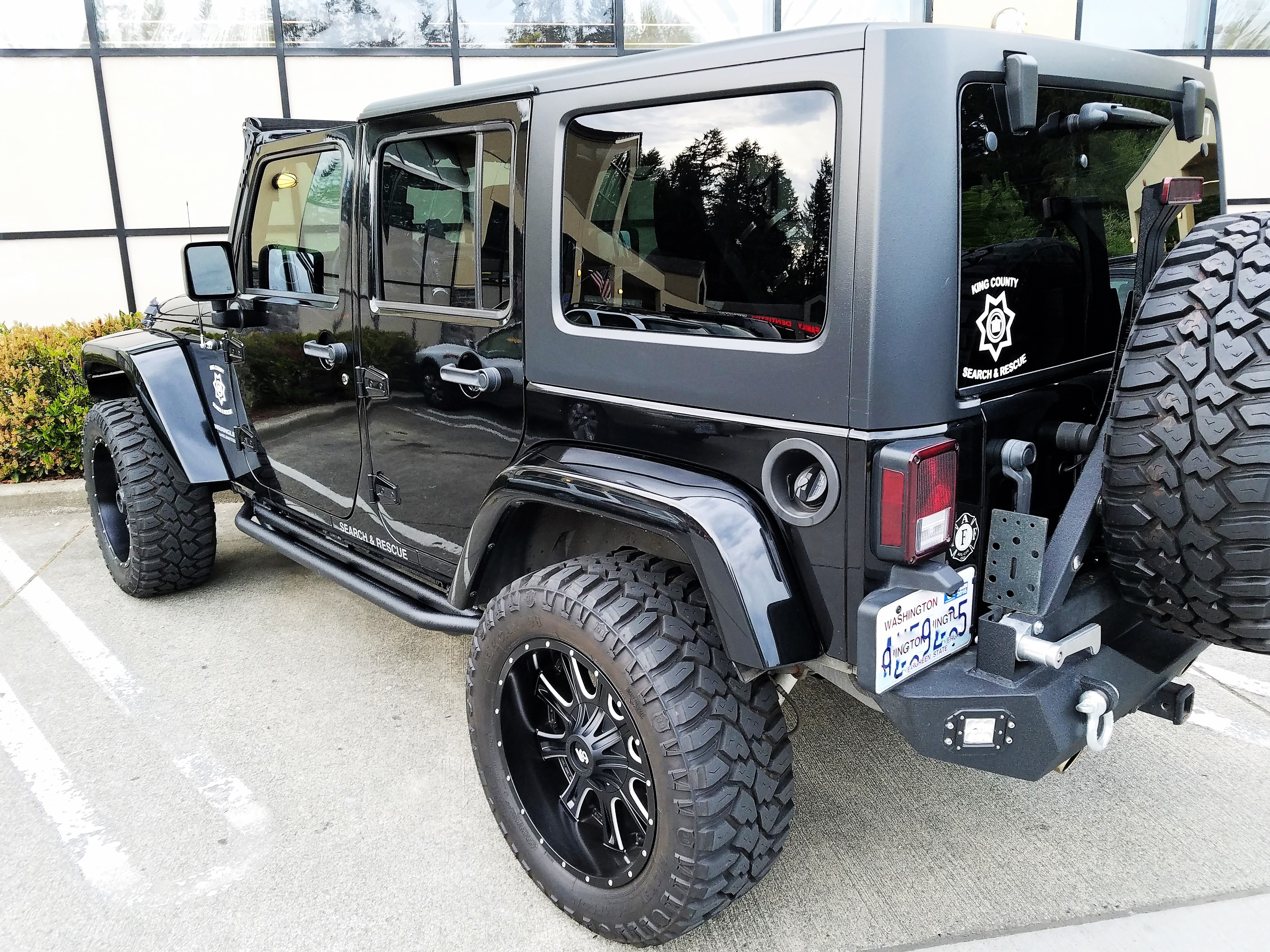

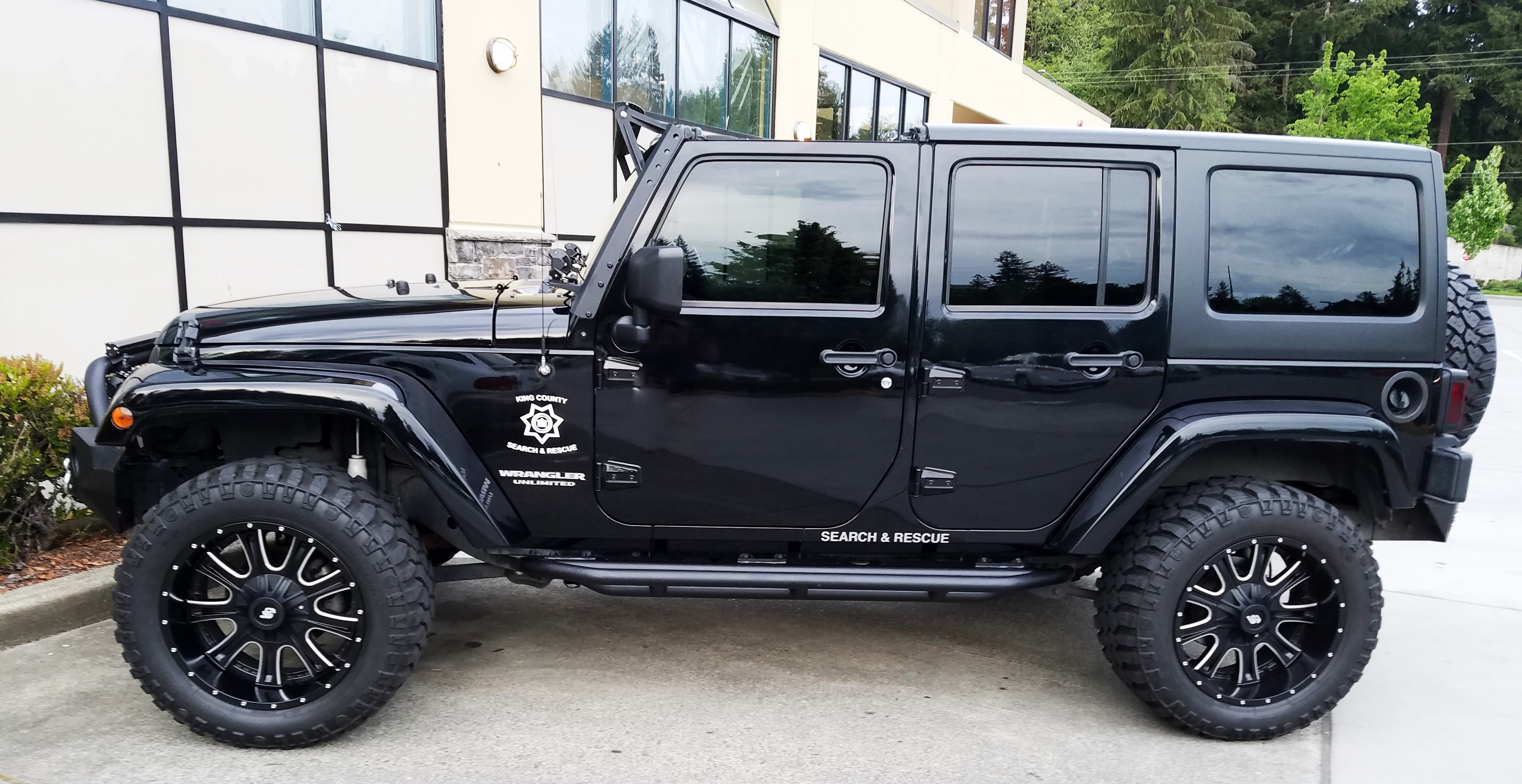

Default Itemized JK build
Wheels: (5)LRG105, 20x10 - Black Milled
Tires: (5)LT305/55R20, Mickey Thompson Deegan 38 - Mud Terrain
Suspension Lift: Zone Offroad Lift Kit 3" Coil lift with Hydro shocks
Body Upgrades:
Front Bumper: Barricade Trail Force HD Full Width Bumper
Rear Bumper: Rock Crawler Rear Bumper with Tire Swing Out
Rock Sliders: Redrock Side Armor
Winch: Smitybilt X2O 10K Waterproof Wireless Winch
Jack : Hi-LiftJack 48" Hi-Lift X-TREME Jack
Upgraded Lighting:
Headlights: 80W LED 6000K Bulb replacements
Fog Light Bulbs: 80W LED 6000K Bulb replacements
Windshield Lights: 52inch 400W LED Light bar + 2pcs 4"18W Spot LED + Mount Bracket for Jeep JK Wrangler
Front LED Light Bar: 20Inch 126W CREE Led light bar
Backup Lights 60WLED Bulb replacements + 18W Flush Mount LED Flood lights
Stereo/Navigation Upgrades:
Stereo Insane JeepAudio | In-dash Navigation and Multimedia Entertainment System GPS,Bluetooth, Backup Camera, ODBII Connection
Front Speakers PolkAudio 6.5-Inch 2-Way Component System
Rear Speakers PolkAudio 6.5-Inch Coaxial Speakers
Subwoofer Polk Audio DVC 8-Inch Subwoofer (Stock replacement) + boxed JL Audio 12W6v2 (removable)
Amplification: Soundstream 5-Channel 950 Watts RMS Amp
Engine/Drivetrain Upgrades
Engine tuner: Diablosport Performance Tuner tire/gear adjustments and engine performance tuning
Muffler: Dynomax Dual Outlet Super Turbo Muffler
Gearing: 3.21 to 4.10 Regear
Differentials: Detroit Locker Rear TrueTrac rear limited slip differential

Can you tell us more about how the vehicle is used in search and rescue operations? It looks good but many people buy all of the lights, sound system, and big wheels but obviously are not involved in SAR efforts. I'm a little surprised that the vehicle doesn't have a snorkel yet to go with the theme as well as the exhaust system and tuner. Do you also carry an oversized snatch block to utilize your winch in heavier conditions?

Looks like it's searching for its first off road run period.
Then again, another rig will need to rescue that dolled up Sahara. Way too much armor all to grip on the non existent sidewalls with those 20s.
In order to do deep rescue recovery you'll need a GOOD winch 12k minimum. Also, consider a larger tire on a smaller wheel. Without on board air, a welder, and no back seat to keep more tools and supplies. . . Fair to say it's just a search vehicle.

Let me say that my Jeep is first my daily driver and was put together as such. All of our local S&R groups are 100% volunteer with zero corporate funding so there will be situations I’m comfortable putting my Jeep in and some I won’t. It’ll never have a snorkel because I’m not willing to put my rig through hood-high water but it’s perfectly adequate for the snow routes, brush trails and logging roads very common to our local missions. I’m certainly not the hardcore off roader that I’m sure is prevalent here and that is somewhat prevalent in our group but I can assure you that 99% of our calls don’t require a 12K+ winch and a welder but thanks for your input. I’d didn’t build a rig I’m going to beat the ever living crap out of but I am happy to risk my investment for the sake of others when needed.

And you blurred the front plate, but the rear is clear as day.
Clerical errors, I'm sure. What rear bumper is that?

It's from Tuff Stuff: Tuff Stuff 07-16 Jeep Wrangler JK Rear Bumper & Tire Carrier - Tuff Stuff 4x4 | Winches, Off Road Lighting, Overland and Accessories
