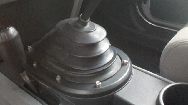

I was bored today. used 1/4" stainless allen heads. Took it apart in drilled the top plate to 1/4" n the bottom plate to 7/32" to catch some thread. Dab of super glue on the threads n its good!!! What ya think?? Total cost $8.64 for the bolts!

Very nice. I did the same thing a few weeks ago. I actually used some Chrome bolts from Ace for $0.45 each.
