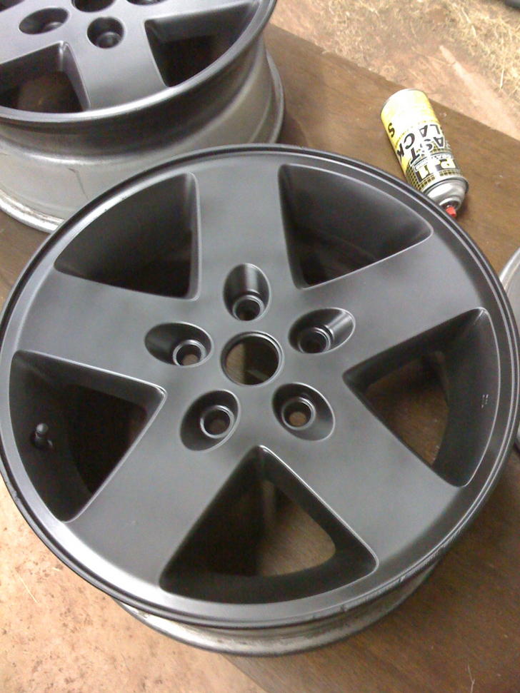

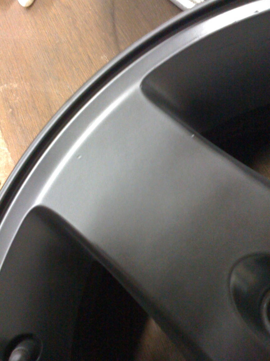

Here's mine painted...
Up close....
A quick rundown....
I took off all 5 wheels leaving the jeep up on jackstands. I suppose 1 or 2 at a time would work, but I wanted an "assembly line" so I could work through all five and by the time I was done with number 5, number 1 would be ready for more work (for the most part). Tires were left on for the whole process.
I sanded each wheel inside and out with a fine grit paper.
I let some air out of each tire to allow me to wedge posterboard between the rim and rubber. I cut a bunch of small pieces of the posterboard with small curves to shield the tire from spray and carefully set it up.
I used self etching primer first on the front and back of each wheel. I put a few light coats and lightly sanded just to make sure it was smooth all around.
After the priming was all set, I used Rustoleum Hammered black spray paint. Once again, set the posterboard template and several light coats on each wheel inside and out. I didn't really worry about making sure the inside was perfect, but I wanted it to be black. I used quick strokes on the outside taking a lot of care to make sure it looked great.
I let everything dry overnight and threw the wheels back on the next day. It's been well over a year and I've only had to touch up one spot. The reason I used the hammered paint was so any touching up would be easy. The textured finish allows you to kind of spray and go if you need to do anything rather than redoing all the prep work.

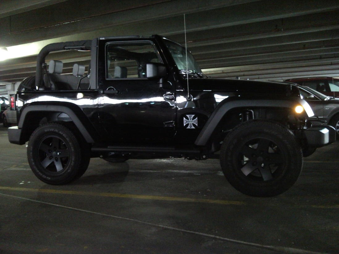

Here you go guys mounted, I sprayed the center caps and lugs last night and they came out really nice but will probally need one more coat to match the wheels perfectly.

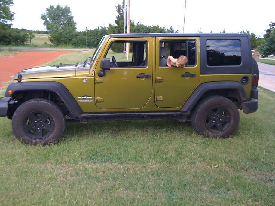

i sanded with red scotch brite pads then wiped down with lacquer thinner then a tack cloth. kinda wished i woulda used self etching primmer but only because i had to grind some rock rash off and paint dosent like to stick to raw aluminum. i painted with pj1 satin black case paint. this is epoxy paint. 8 dollars a can, used 3 cans.
i took the tires off to do this

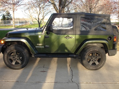

I had my factory Sahara wheels painted Black by a local paint & body shop guy (on the side). They were going to be about $85 per wheel, but the price jumped to about $140 per wheel when I added the Sunburst Orange painted wheel slots (inserts) and the center cap too.
The guy (Mike) did a great job. He painted the entire wheel black (front and back sides), plus coats of clear-coat. He kept the tires on the entire time, but he did knock the wheel weights off so I could have them re-installed on the inside of the rim. I took the unbalanced rims to my local dealer who balanced them with weights on the inside.
I know to each their own, but I have received many positive comments on these wheels. I'm glad I spent the money for the look that I wanted.
