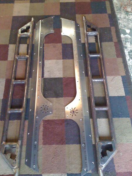

i dindt keep pics of the build but this was after the build and before welding supports that mount to frame

Those are going to look sick! Did you cut the state outline yourself? If you did, that's some sharp work there!

are the sliders customs by EVO ? those look good

no they are not custom by EVO, i work in a fab shop and had the burning table guy write a program from a template i made for the cut outs. i did however use evo's measurements after speaking to them and promising them i would only make a set for myself. Where they use 1.75 dia. tubing i used 1.5 but kept their overall top to bottom measurment. The weight should be about the same being that EVO uses 1/8 wall and i used 3/16 wall. The best part bout the whole project is the only thing it cost me was time and bedliner. The tube was left over boiler tube from a heat exchanger we built at work. i will post pics in the near future with them installed, i have to be here (at work) with a welder (have to have two people here no matter what) so im taking my time and bedlining them tonight. thanks for the compliments, but then again i dont really care who likes em or not, i do and thats all that matters. LMAO
