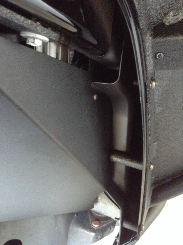

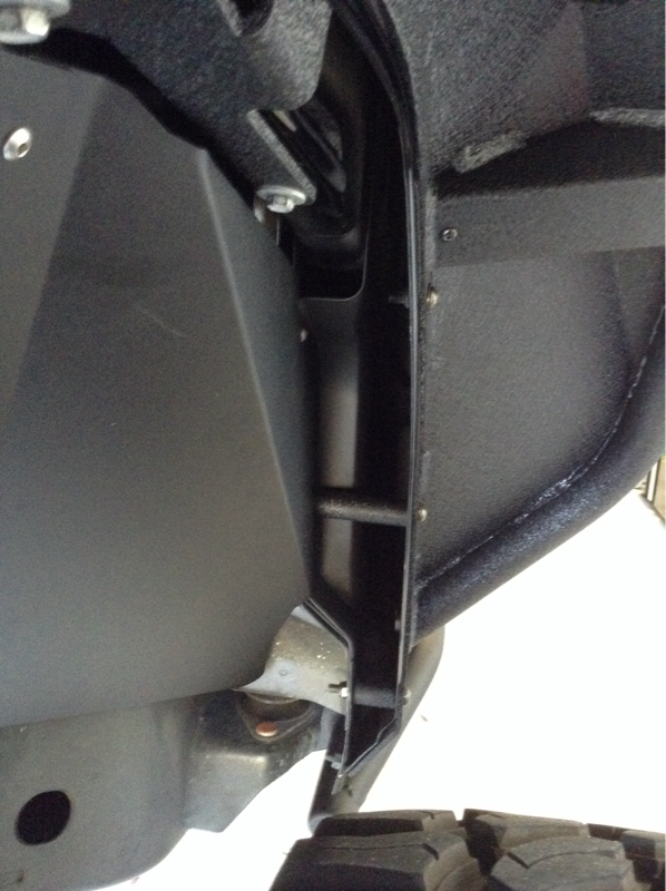

Finished the install of the fronts yesterday, these things look bad ass. Install was pretty strait forward, no real issues to mention. I also added some Crawler Conceptz inner fender liners to complete the whole look. The only issue I was not real happy with is, once you remove the factory inner liners it exposes a cavity in the body. In my particular case when this cavity was exposed it really stood out due to the factory paint not getting into the area (I have a black jeep) so I took some Rustolem flat black to make the cavity lees noticeable.
Here is a shot of the cavity now painted.

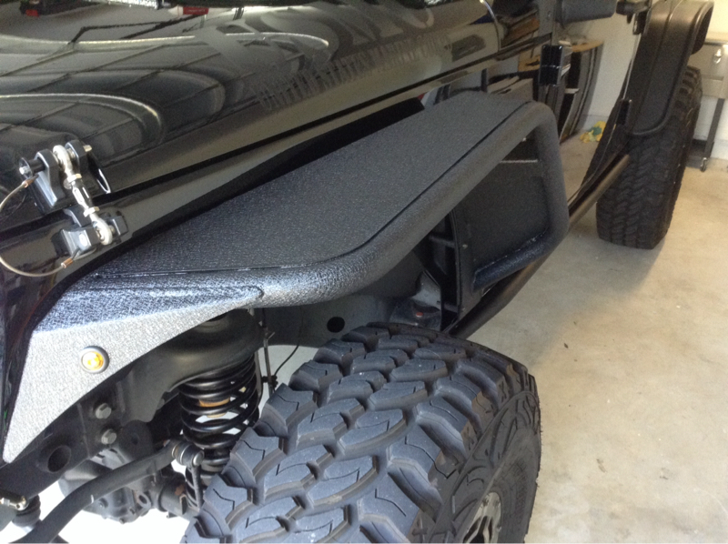

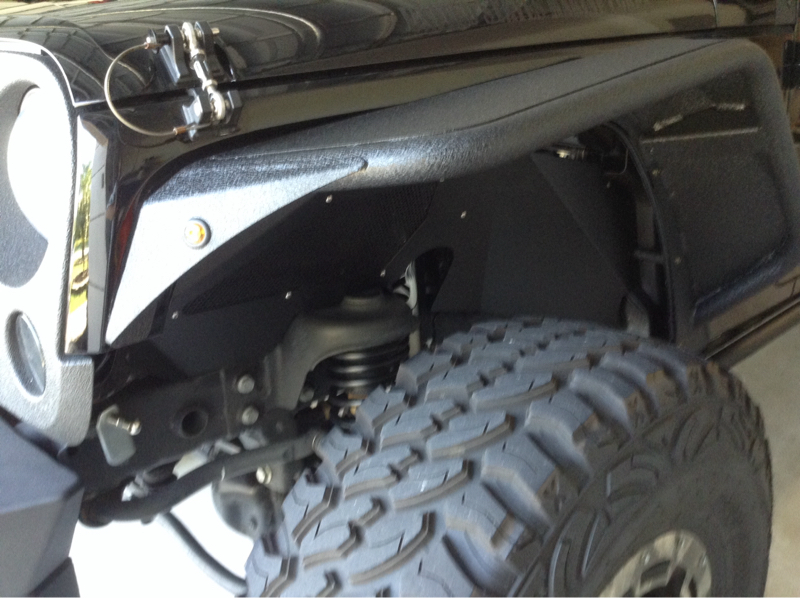

And now the finished install of the front
ID:	646428 Click image for larger version
ID:	646429 Click image for larger version
The multi angles on these things rock!!!!!! I will start the rears this afternoon and repost when completed.
