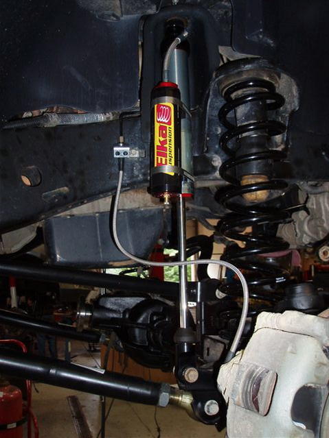

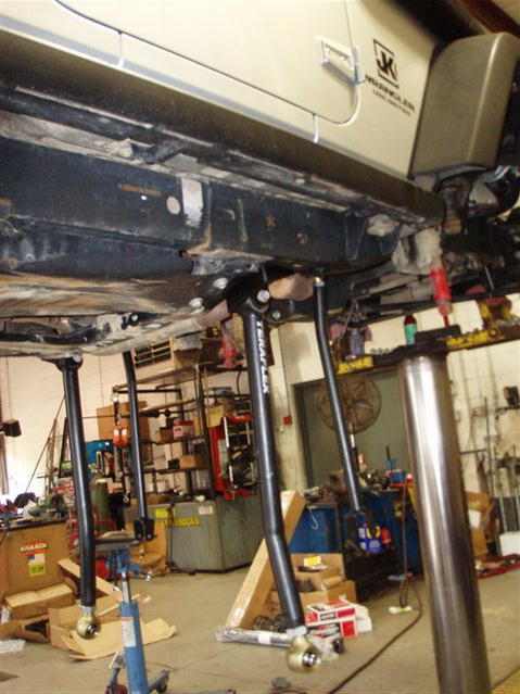

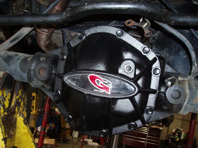

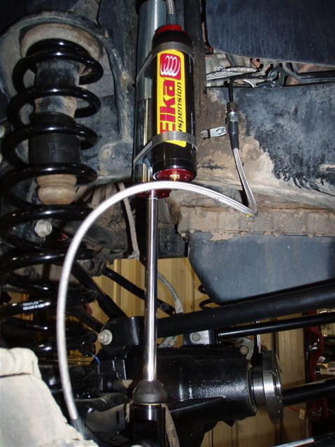

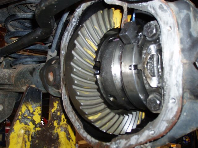

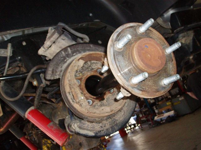

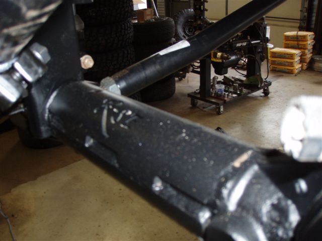

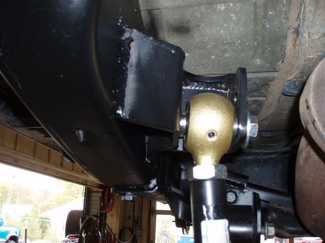

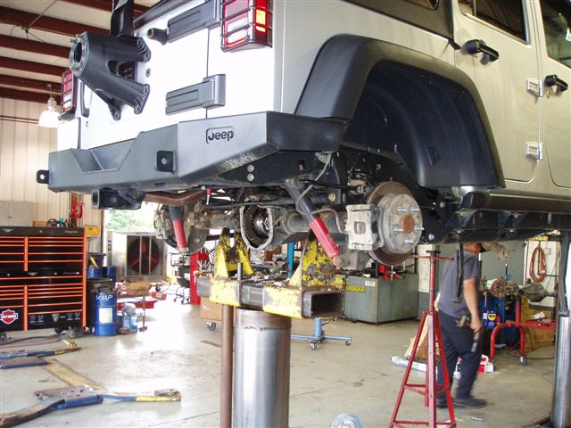

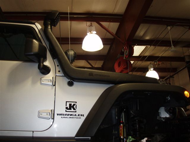

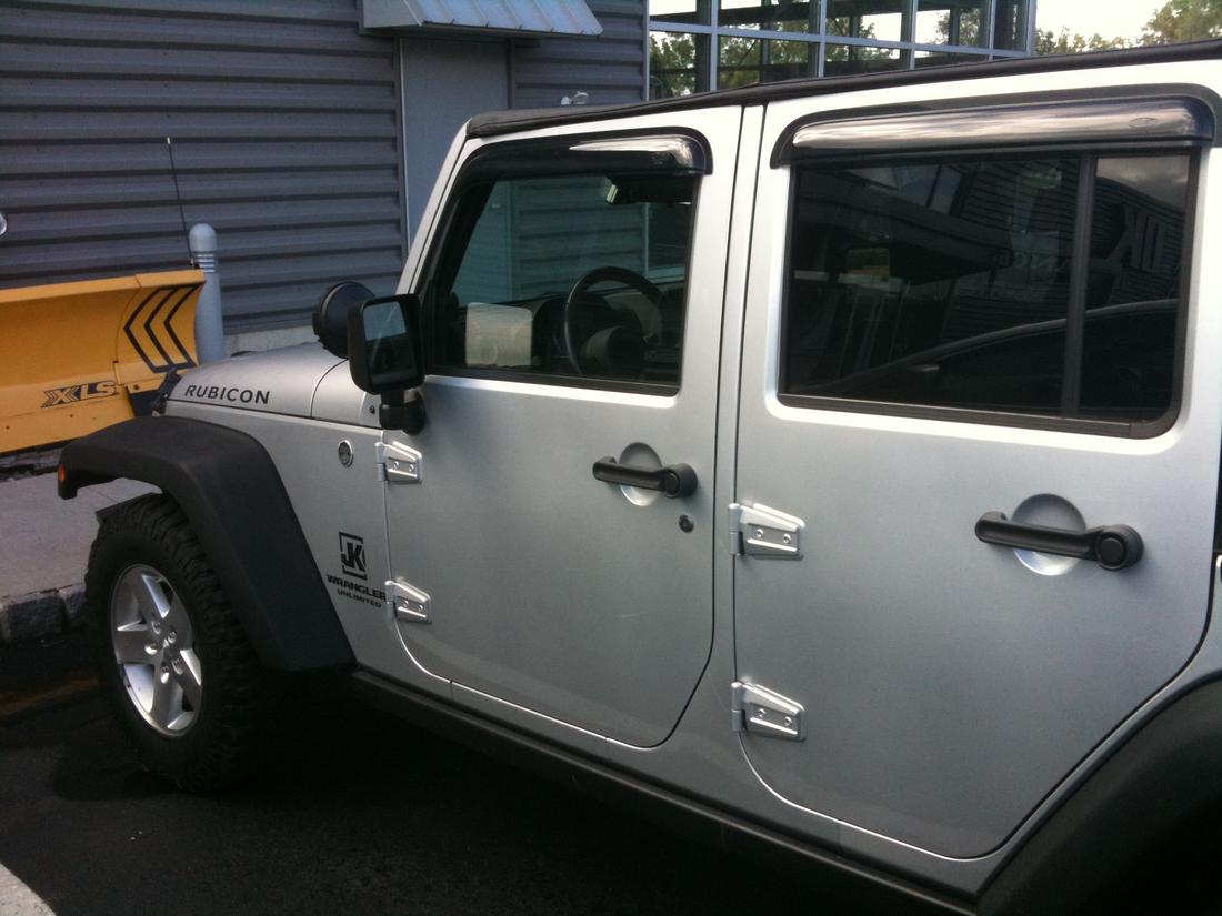

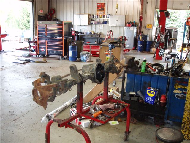

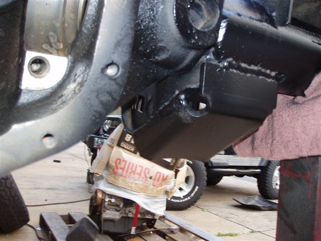

Sorry this has taken so long. Here are a couple pics of the build (I can't get the timeline thing on my JK profile to move pics around after import). There are a couple of "before" pics included.
Hopefully, this will be finished this weekend.
Before:
Build Starting:

Sorry I missed this thread, I was Jeepin in Hawaii when you started it . You can run 37's with a TeraFlex 3" but you'll want some extra bumpstops for it, to protect the tires. Let me know what you think about the ELKA's. If you have any questions, give me a call.

Quick question: I'm running the 3-4 Elkas. Can I run the EVO rockstar skids with that setup?

You would have to switch to a shorter travel 2.5" ELKA to use those. So I wouldn't suggest it, however I would suggest getting some rear shocks skids from EVO or from ORW ( I have these with my ELKA's).
