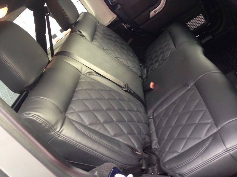

Last weekend I installed my leather seat covers and I could not be happier.
The quality and fit is amazing. I highly recommend them to anyone considering going with leather. It's more of a Mercedes S class/ Bentley type feel. I did the install myself over 2 days.
Troy from star fabricating is really a great guy. I can't say enough positive things about him, his product or support.
Shipping was fast I had these in my hands one week after they were ordered.
