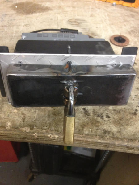

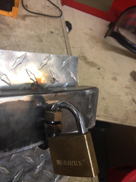

Working out the locking cover.
So basically the plan is to drill a hole above and below where the cover fits onto the face plate. The top pin welded to the cover gets fitted in first then the bent rod with the nut fits into the bottom matching up to another nut welded to the cover. Slide the lock through and taadaaaa. Concealed and protected head unit.
This was just a test piece of diamond plate by the way. Wanted to get the hole placement on scrap first.
Old Apr 12, 2012 | 08:35 PM
keithvegas's Avatar
Posts: 780
From: Las Vegas, NV
Locked and loaded

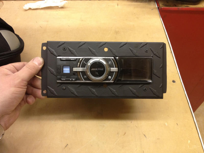

Old Apr 12, 2012 | 10:33 PM
keithvegas's Avatar
Posts: 780
From: Las Vegas, NV
Paint it black
