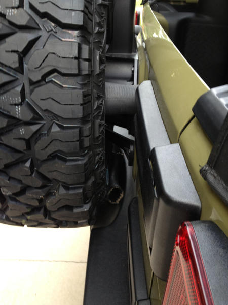

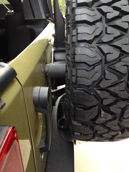

They look ghetto but they work. Got some radiator hose and slipped them over the bumpstops. Even used the left over and wedged it between the tire and bumper. No noise from the tailgate. Temporary until I can get my Teraflex carrier. I wanted my space back in the cargo area.

Did the same thing. Been almost a year on there. Good solution for a few dollars
