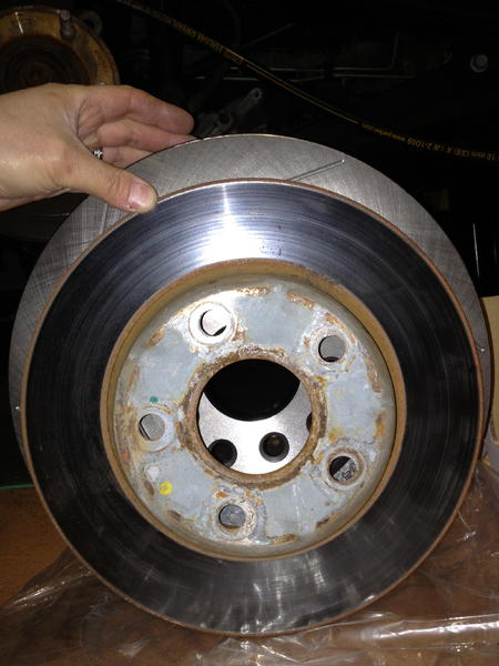

Installed the Teraflex Big brake kit and upgraded master cylinder a few days ago.
Stock and Teraflex rotors.

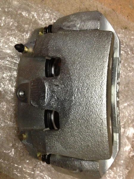

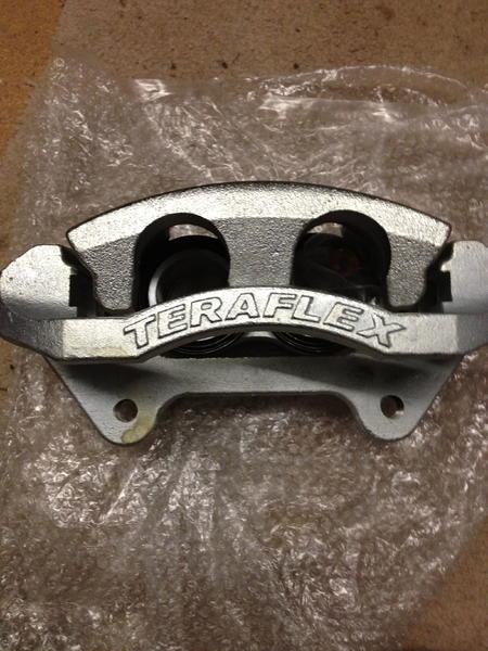

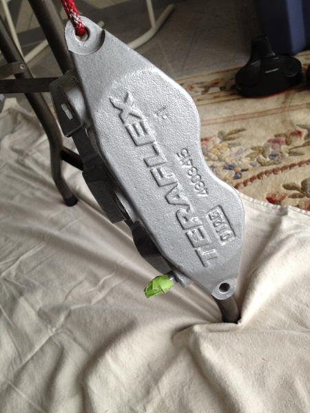

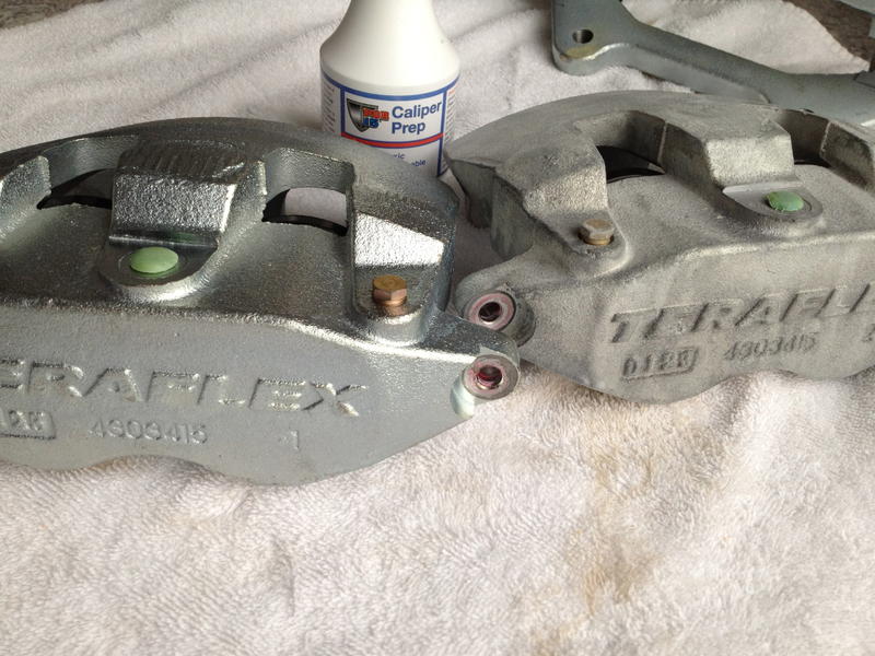

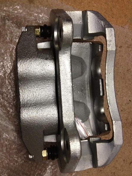

Stock Teraflex calipers.

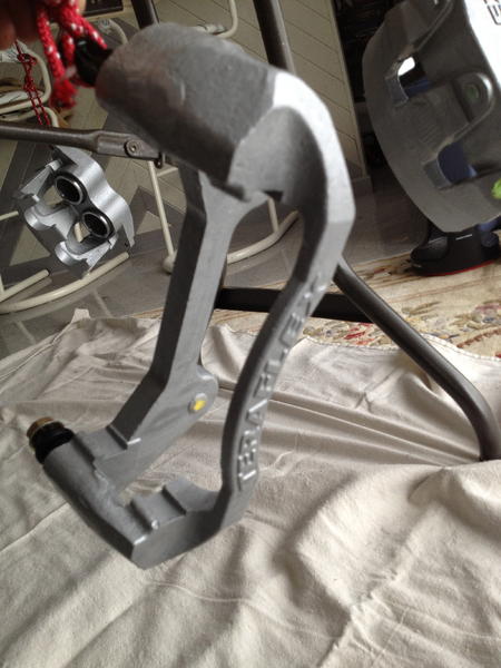

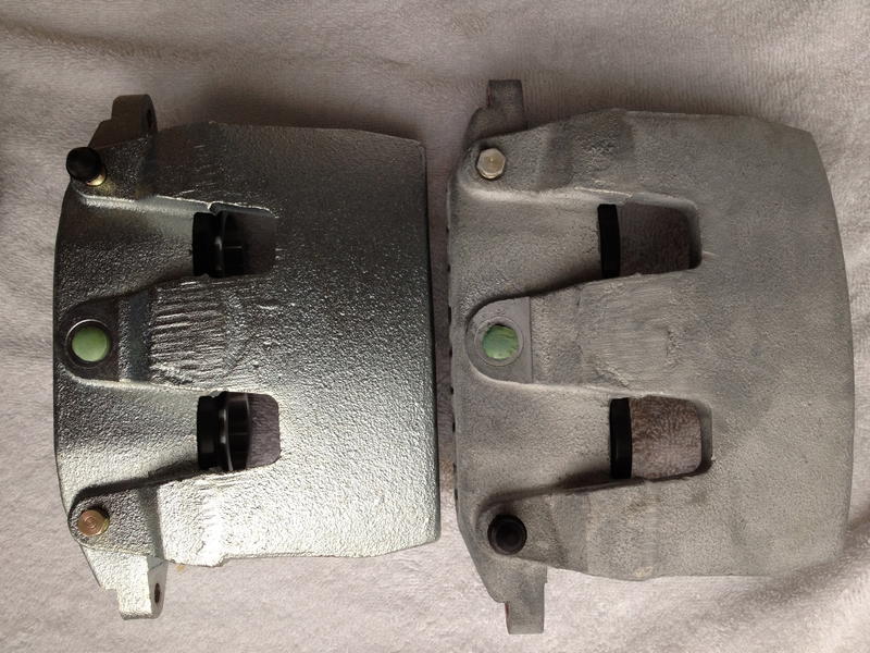

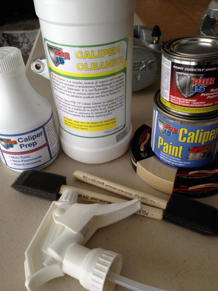

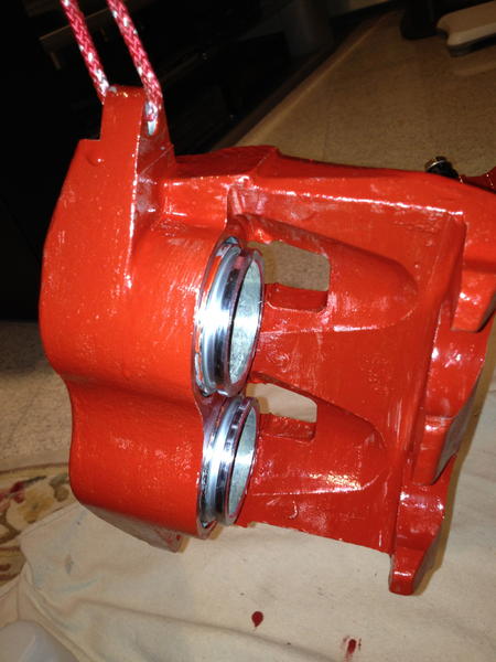

I decided to paint them with POR 15 caliper paint $40 from the local speed shop. you can see how the caliper prep solvent "etched" the caliper for the POR 15 paint.

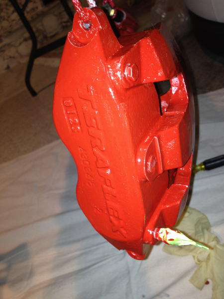

after POR 15 paint.

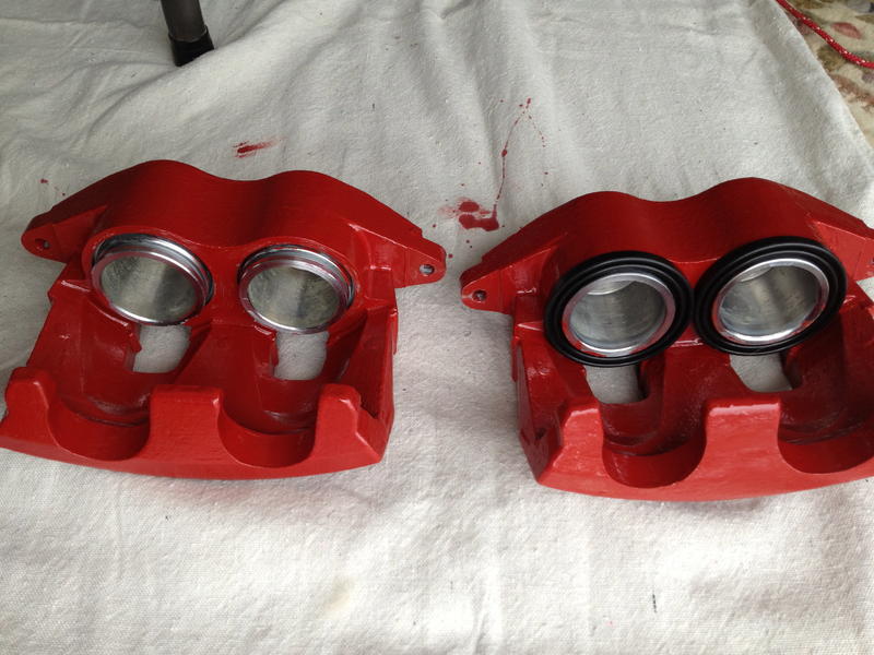

I Removed the dust boots for the pistons for painting and then reinstalled.

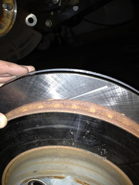

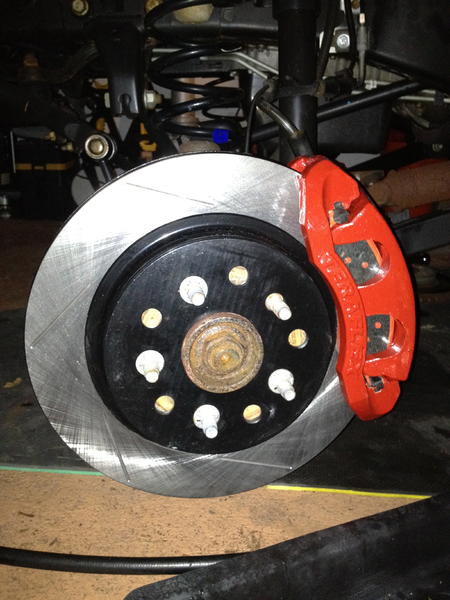

Installed on the Jeep, one thing i was dissapointed in was the rotors, both of them were slotted in the same direction, so it looks like the drivers side rotor is backwards. I contacted Teraflex and they said the rotors make no difference which way they are facing. even though the picture on their website shows a left and right rotor.

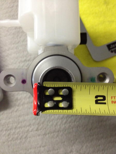

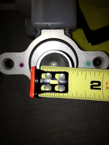

Pic of the upgraded master cylinder.

After bleeding the brakes and bedding in the pads there is a very nice improvement in braking.
I'm glad i went this route instead of stock.

What as the size different in the MC piston you show. I couldn't make it out, and teraflex refused to answer me....

btw, tempted to use the por kit as you did also....what store did you get it at. wondering if its a chain.
