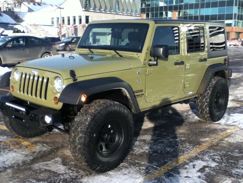

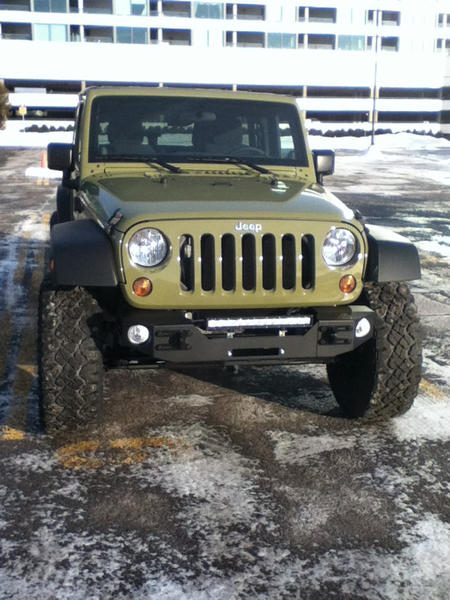

315-75-16 on procomp 7069 with a teraflex levelling kit and rubi 19/59 coils

commando looks great. I almost had one but the gecko pulled me in haha

What front bumper is that?

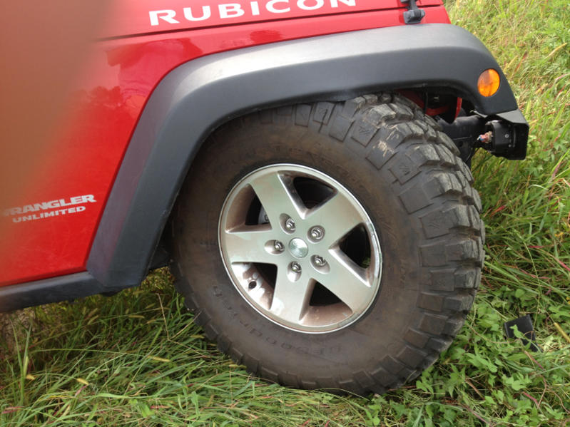

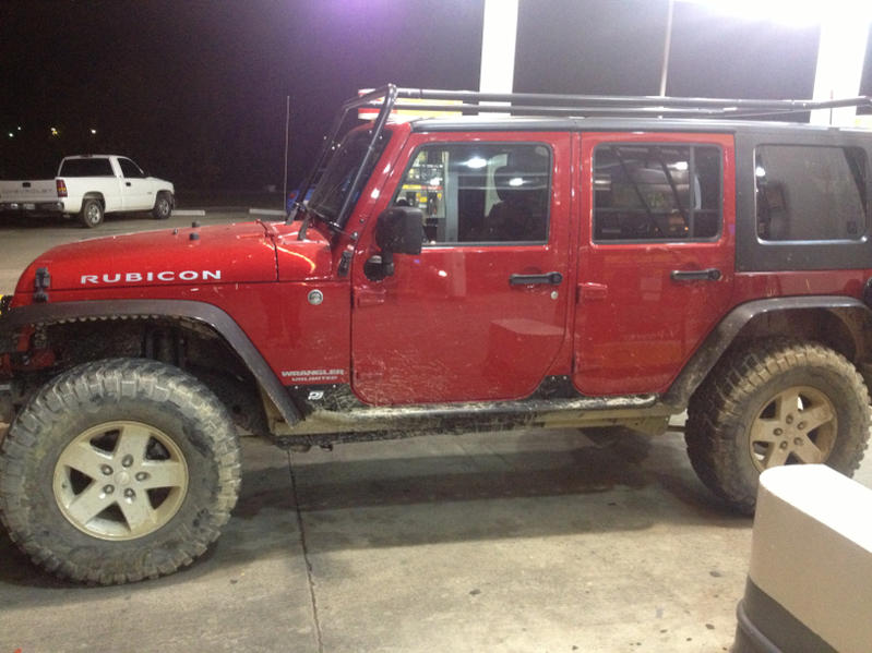

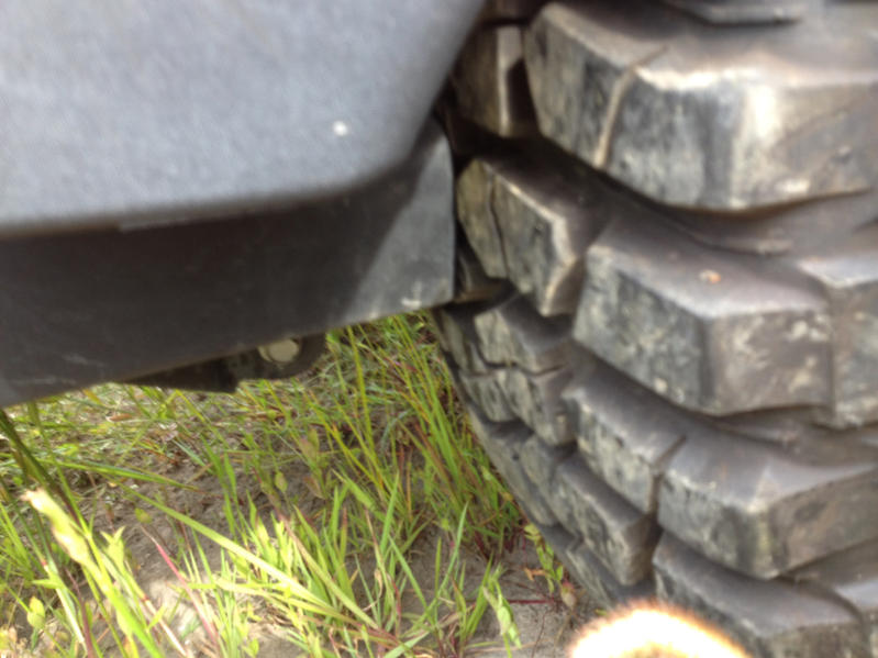

I'm running 35x12.50 BFG mts on the spring kit. They do rub the stock fenders when disconnected. Even with flat fenders, I still rub the upper seam in the passenger fender well. Oh and I have 1.5" spacers.

Rough country hybrid stubby with fogs
