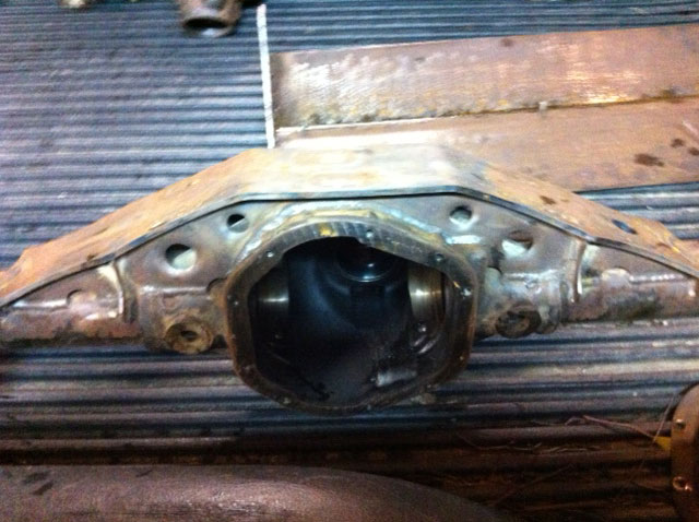

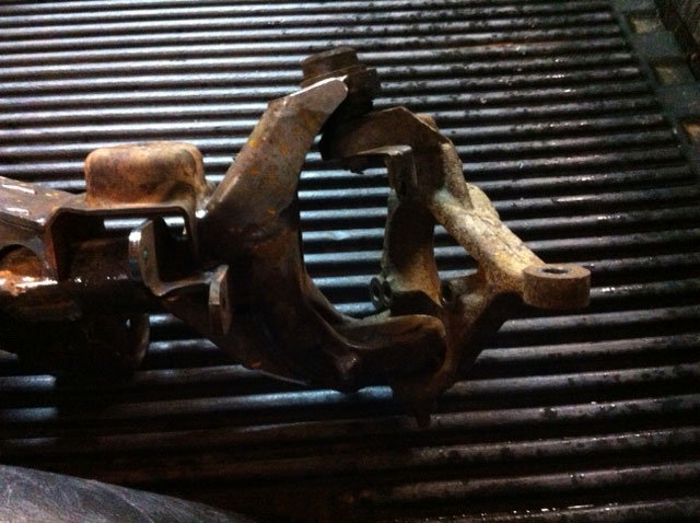

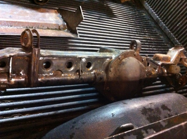

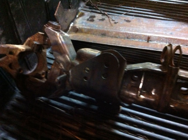

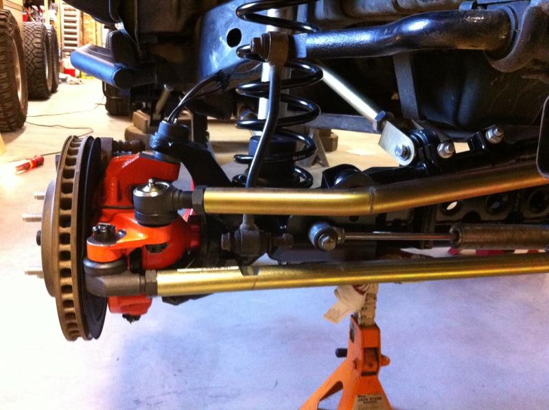

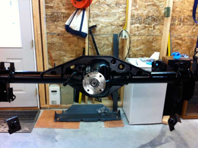

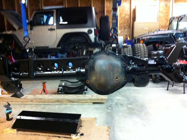

Finally doing some overdue improvements to my `07 Rub 2d. Funny how life gets big the older I get...been waiting a few years to do this.
I`ve had this JK since new. I added a 4" Pro Comp stg 2 that summer `cause that`s all there was. Yeah, I know. Shoulda waited. Added JKS adj rear UCA`s in `08. GOOD STUFF. Expedition One f/r bumpers, Walker Evans beadloc w/35-12.5-17 GY MT/R`s, also in `08. Now after a few years of dd and offroading, it`s time. I`ll be swapping out PC to Metal Cloak 3 1/2" coils, MC LCA`s f/r and UCA frnt, MC tie rod & draglink, Artec gusset/truss f/r, Yukon 4.88`s, Synergy ball joints, Reid knuckles, CRV frnt axles, TF monster track bars f/r.
Here`s a few pix of progress.

how's the artec kit for the the front? install good? I'm thinking about getting it for mine also!
Their product is top-notch!!! The fitment is superb, even around the diffs. The install was pretty straightforward, JUST FOLLOW THE INSTRUCTIONS. Just take your time and pre-heat as instructed to avoid warping. I highly recommend this product.
