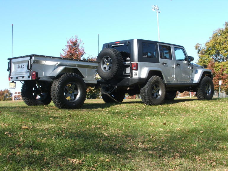

Here is my 2 cents on this. It's great if you can match your trailer wheel and tire size with your Jeeps wheel and tire size.
Bigest advantage would be, No need to carry another spare wheel and tire. Your Jeeps spare will work on both Jeep and trailer.
I am running 37's on my Jeep but went to 35's on my trailer. Same wheel but smaller tires. 37's were just to big for my 1/4 ton military trailer even with 5 inches of total lift.

Nice trailer! I guess I am going to run the same height but will have to decide the width!
